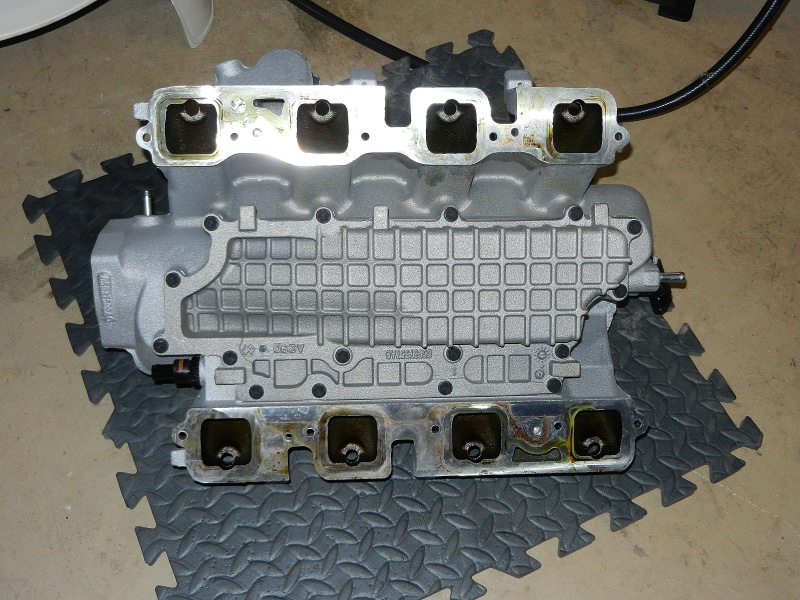

Here's the promised photos of the intake before, squirrel stash of nuts, pre-post porting, reinstallation, and converting the catch can hoses from rubber to braided SS.
There, photos as promised. Wanted to get the heads and a new cam installed before CF3, but that's not going to happen. I have an appointment at Arringtons with AJ next week Tuesday for a dyno tune to get the nitrous ready..
