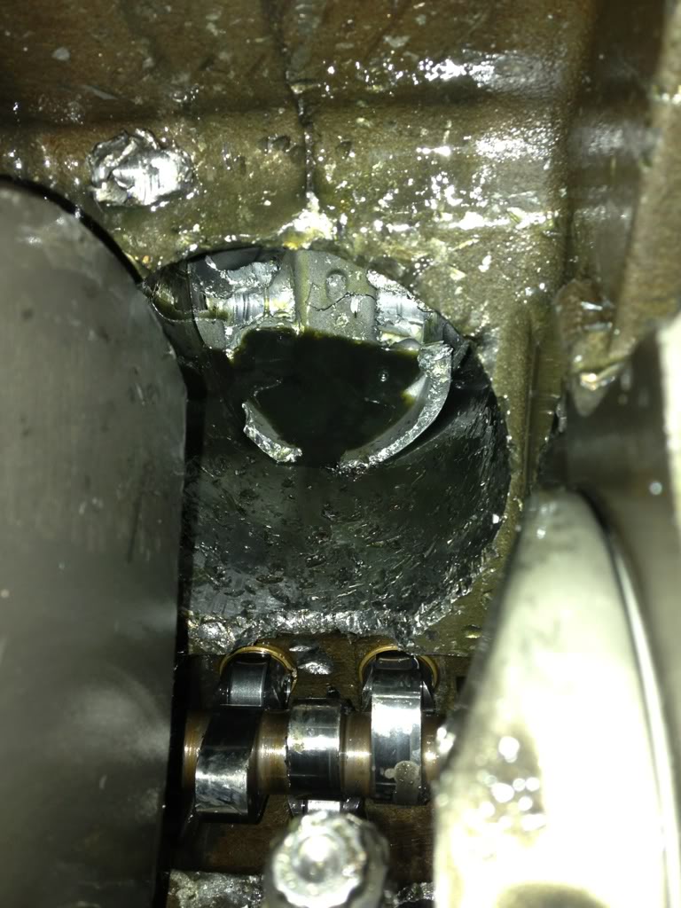

  Found a 400 big block on ebay that was suppose to be fresh build to get in car to get it tagged and running. After engine arrived took oil pan off and pretty much found out I bought a rebuildable( or thought) block. Wiring on car was patched together and looked horrible. Ended up rewiring whole car while engine was out to get built. Decided to stroke motor to 472 cu inch and run e-85.
  First rebuild of engine made around 482 rwhp( after second rebuild) and was running by  spring of '11. Best time by end of year was at mokan dragway at 10.16@132 on 275 drag radials. Ended up cracking another cylinder at end of year.  Video I got that year.
  So send motor out again for rebuild to new builder. Guy is good but real slow lol. Get engine back about May. Engine makes 724 horse on engine dyno. Changed a lot new tranny with trans brake, new rear coil overs, and new exhaust on it. New cam bigger carb and ported heads make car not as fun to drive with the 5500 stall.

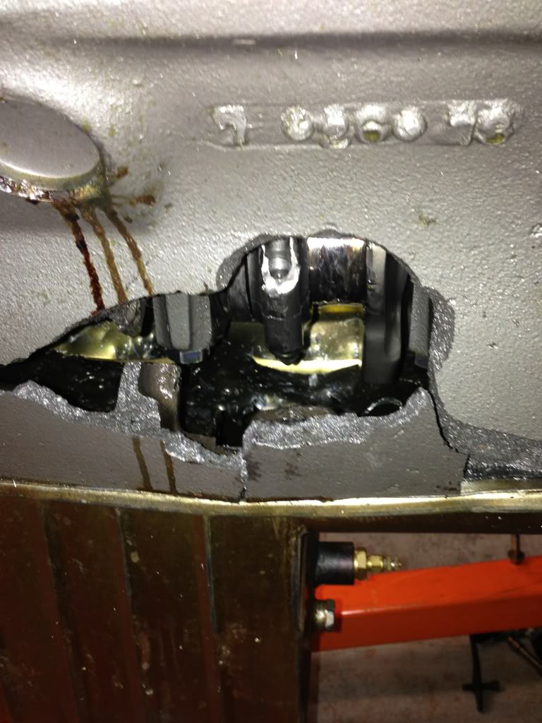

 Had all kind of problems after getting back from harmonic balancer coming loose from rubber causing timing to go screwy all year( crank trigger). Could not get traction figures out at all think torsion bars were finally going bad. Best et could get was 10.03 with crappy 1.56 60' and tranny brake was useless. So what to do when ya cant get 60' down? Get pissed and throw some nitrous to it of course.
 Added 125 shot. Ended up switching to c12 since could not get enough fuel with e-83 on the 1050dom I was running with e-85. Still had to foot brake best that way with 20% of shot on line was 1.51. Had rpm set to low on nitrous controller so it shut off at 1000' but still got my 9' pass. Sorry another bad quality video
 Ran like that for about a month then this.
255DFD20-BE30-47C8-9556-618552462EC9-422
919DFA1B-ACD3-456E-9411-72E669C21576-726
C92857D3-4F61-47A2-8899-5B787F0CAAA4-726
 Bent 6 of 8 connecting rods,tore one piston in half, one wrist pin in half, screw up crank from where one connecting rod rip off of it.

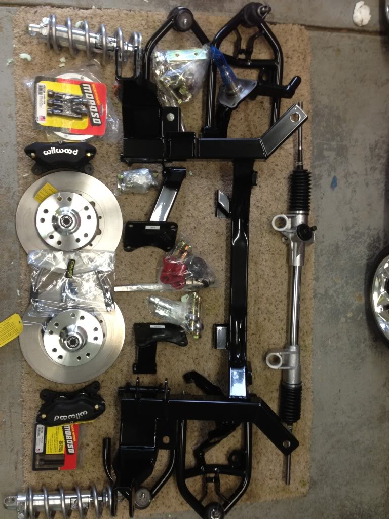

 Sorry for long story just brings us up to date. Decided I want a more streetable car again but hopefully ends with more power. So first parts have arrived.

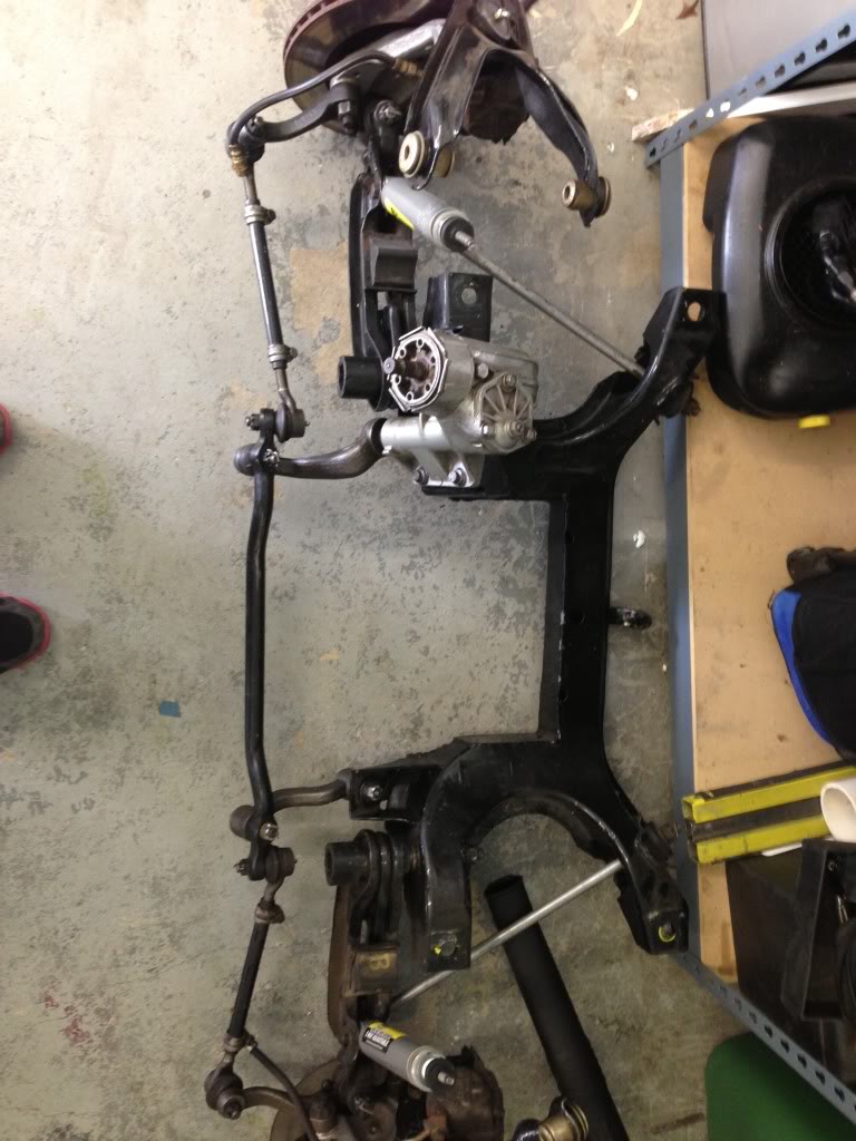

 Old with the old heavy K member
E1BB2040-FE24-44B2-8727-3494B4B1C092-668

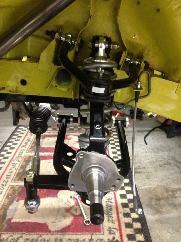

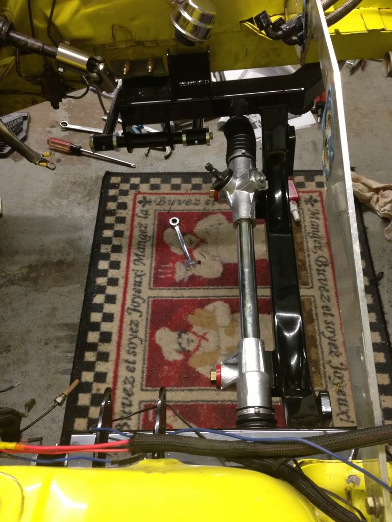

 And in with the new Alterkation front end with wildwood brakes and gen3 hemi mounts. Not finish with install yet but here a couple
B76BCE9B-D0DA-4D6D-86B0-D797C7A32B07-668
75133FEA-D414-41A7-89F2-A7FB2C5A47FD-668
CF099740-CF15-461A-A7FE-A51F6156759E-668

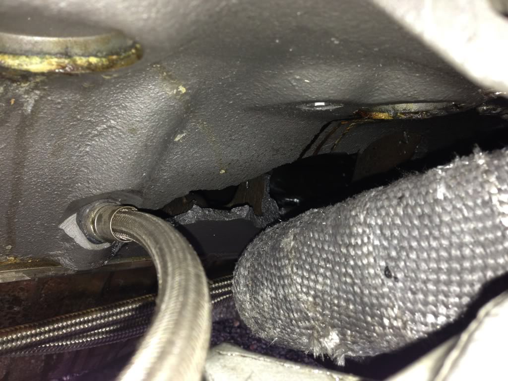

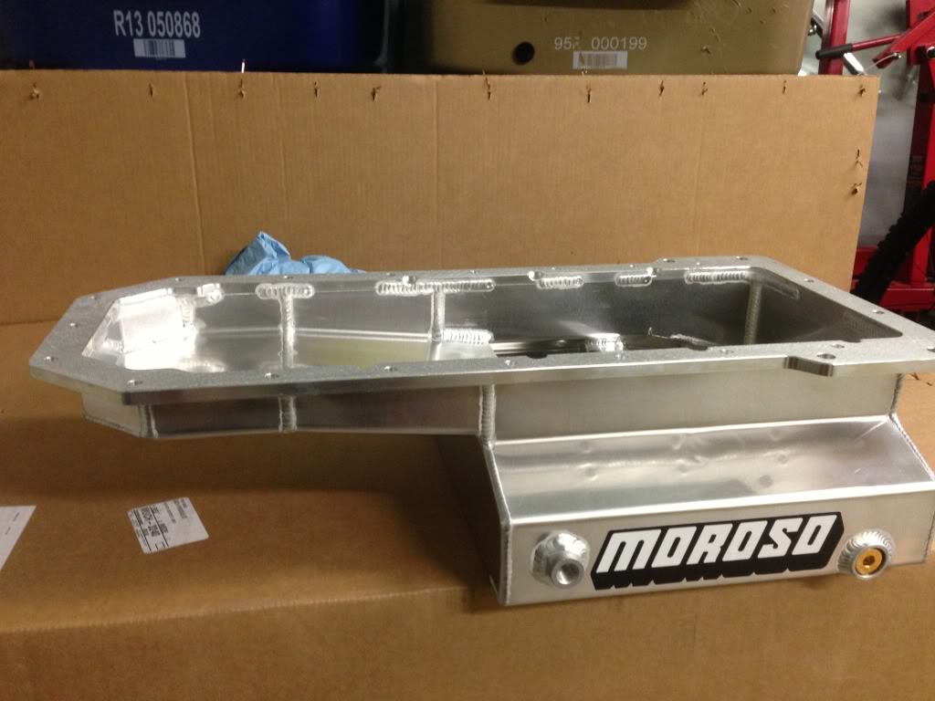

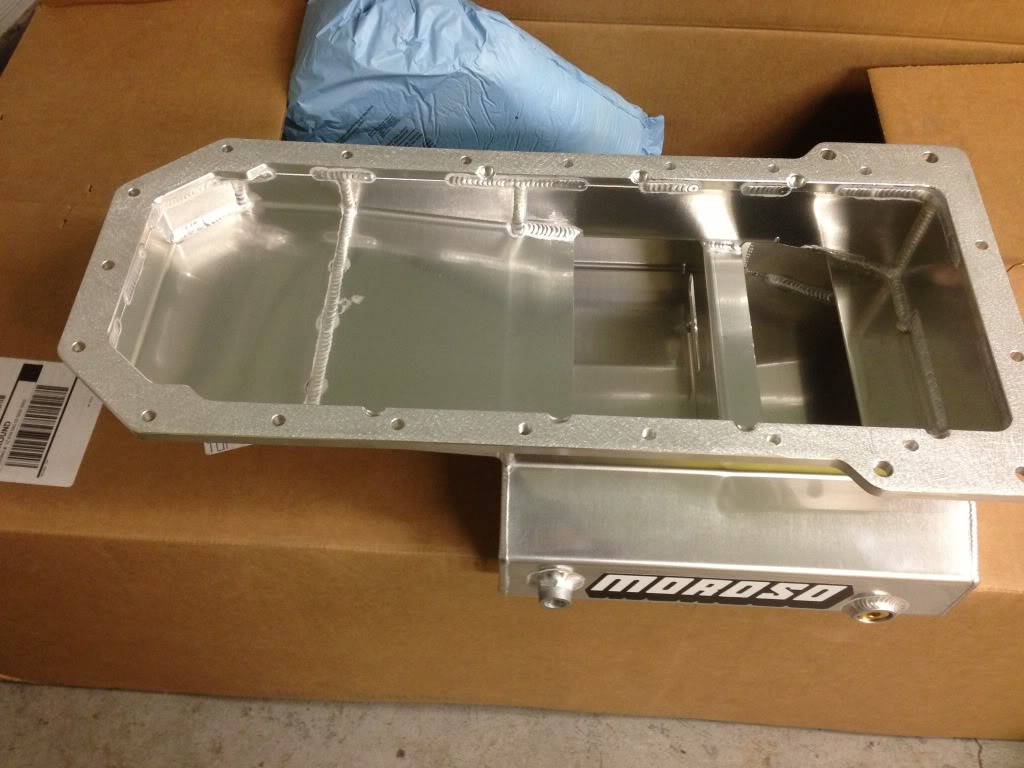

  Also oil pan designed to fit new front end
A657ABE4-C236-41DE-8BB2-46C87432BBF0-671
09CD963A-B5FF-424E-A4F4-2AEBBFED6ED8-671
After talking to friend at Bullseye turbo and Andy with PWR plan as of right now is stock displacement 6.1 with a few goodies in it and one of Bullseyes trick wheeled 83 mm turbos, ATi supercase powerglide, and air/water IC mounted in passenger footwell.  ECU as of right now will be the PROEFI 128. Plans could change as probably won't be running til this time next year depending on how money goes.
