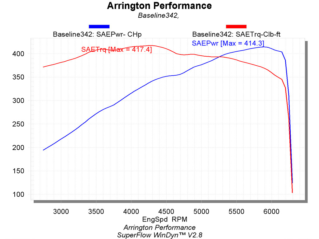

Picture 1. This is a baseline graph done on the factory tune right after pulling the 2014 Dodge Challenger onto the dyno. With a dyno cell temperature of 61°F, and the vehicle warmed to 150°F coolant temp for a pull of 414.3HP & 417.4TQ.

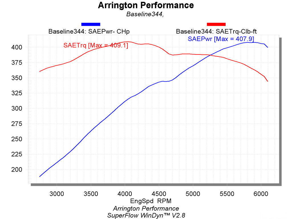

Picture 2. This is the same car on the third pull. Only difference is now the vehicle & driveline is up to operating temperature and the actual dyno cell temp is @ 59.3°F for a pull of 407.9HP & 409.1TQ.

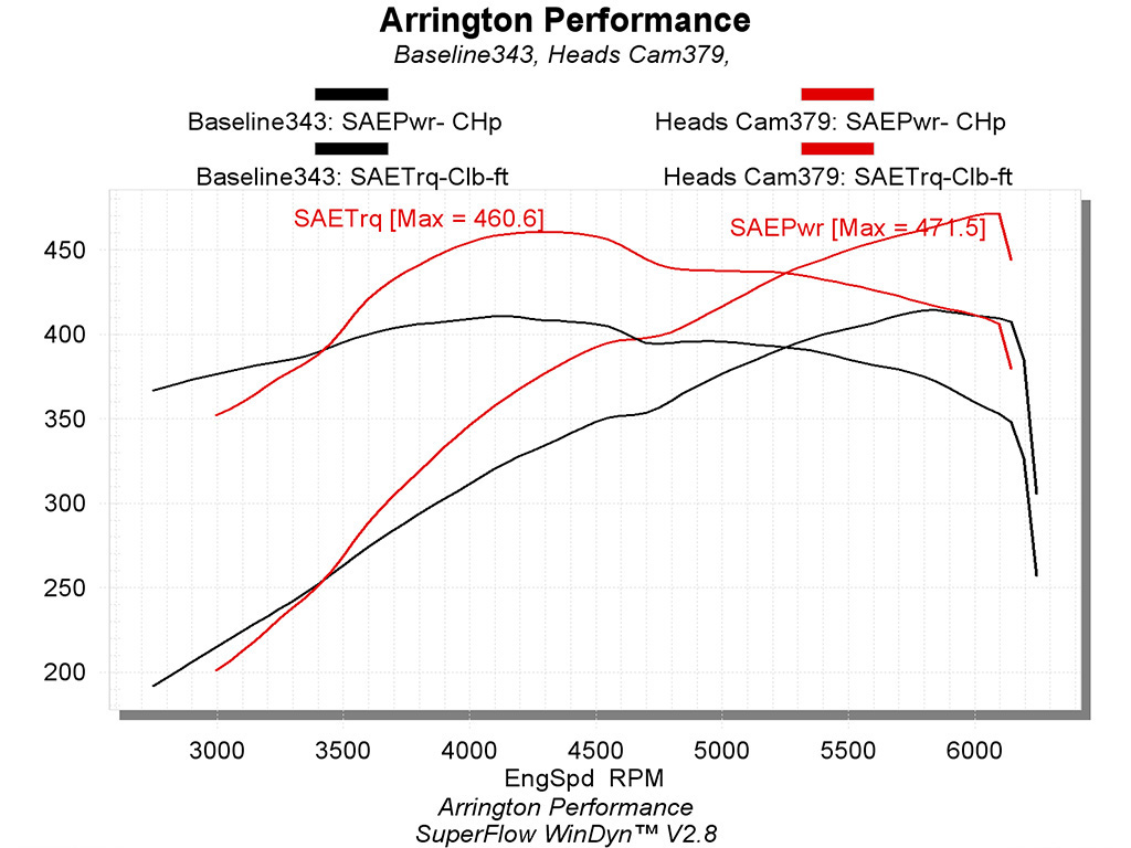

Picture 3With the API Phase 6 Heads / Cam package installed, fully tuned vehicle, engine and driveline at full operating temps the final pull of the day was 471.5HP & 460.9TQ.

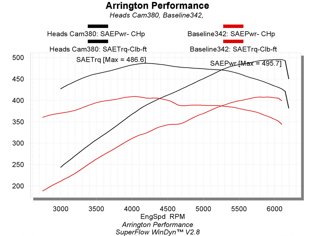

Picture 4The exact same car with the exact same calibration is dyno’d the following morning with a cell temp of 45.1°F. The cooler drive train and cell temperatures are worth 17HP. With the coolant temp at 150°F the max HP pull was 495.7HP & 486.6TQ. This final run has been compared to the “best” cold baseline number “published” showing a gain of 81HP.
Going forward we are going to show the best numbers and the operating temp numbers as well.
Best Baseline of 414HP & 417TRQ versus Best Pull of 495HP & 486TRQ = Net 81HP & 69TRQ
Opt Temp Baseline of 408HP & 409TRQ versus Opt Temp Pull of 472HP & 461TRQ = Net 64HP & 52TRQ

This is what is cool about the new format, the best pull (run 380) shows no loss at the bottom; but the heat soaked run (379) shows that there is a slight loss before about 3300 RPM. Useful to know if you are running back to back at the track...

Looks like on the final tune API was able to clean up the dip in the graph too, nice
