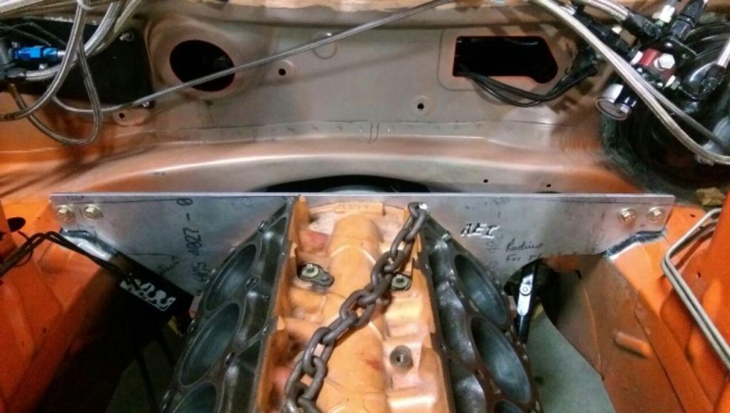

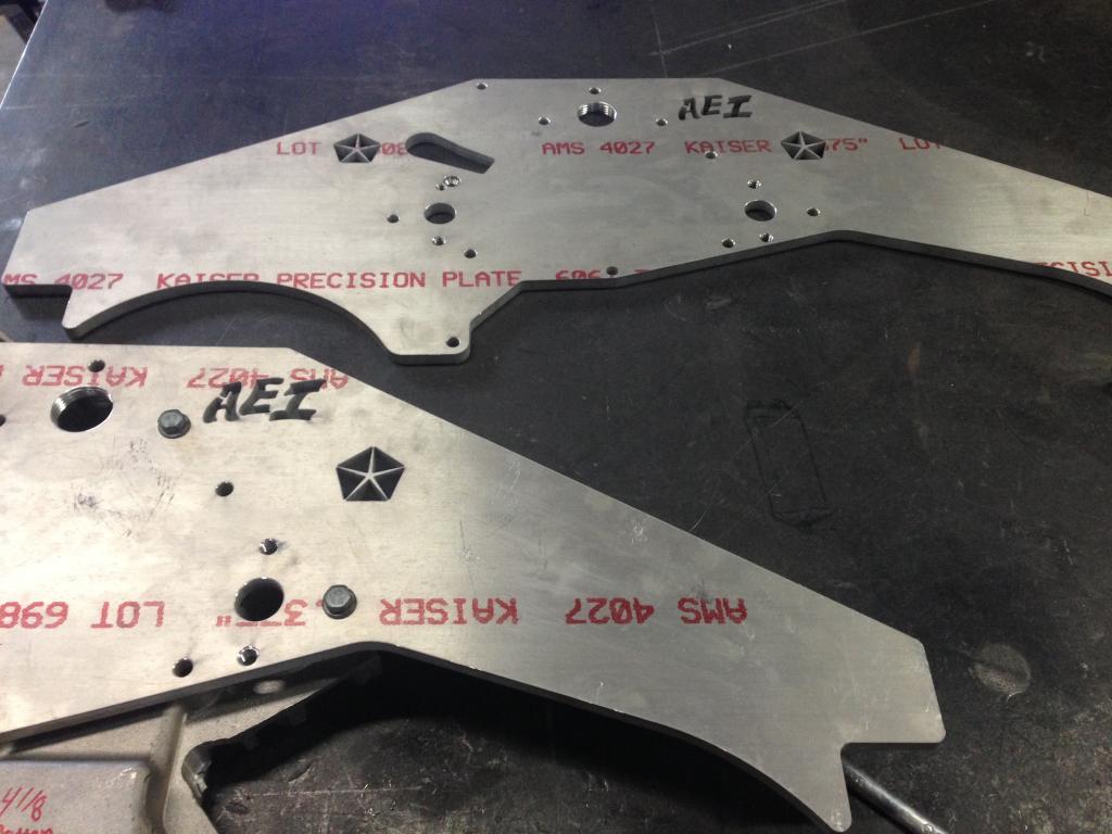

Those motor plates look bad ass.

Yes they do!

Yea they look great AJ. Can't wait to drive it again. lol

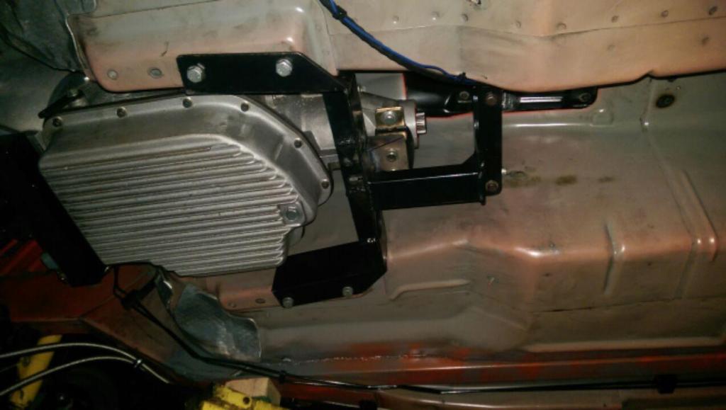

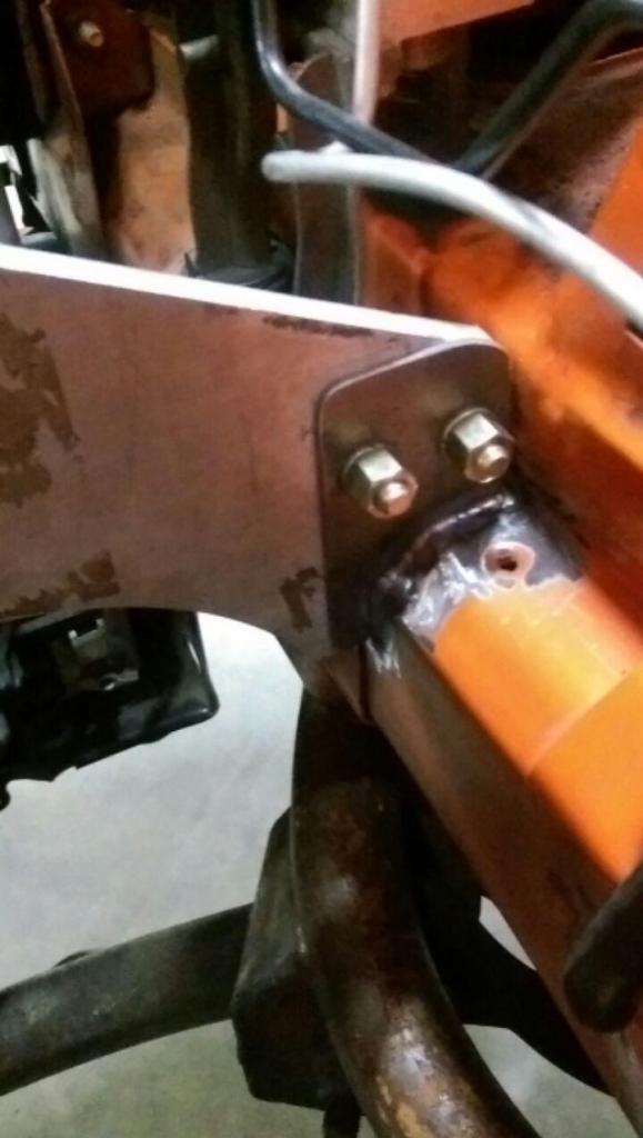

New cross member and Oil pan are in process!

Nice looking plates but man I hate having to pull the motor out of the top... I've been doing all the ones at my shop to still come out the bottom with the cradle..

I don't have a lift, so it comes out the top.

Even with removing the nose, gear drive, And transmission myself and and Brian at the shop were able to remove the engine out of my black car in just under an hour. The goal besides structure was to make the car serviceable in a flat stall environment. Cradle removal almost always ends up in having to reset or at least check alignment being the cradle nuts float in the frame. Another obstacle for someone at the track or in the garage.

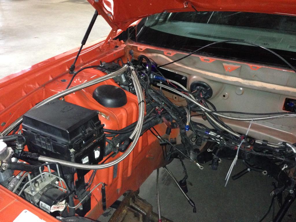

Who is doing your harness?
I just installed my Hotwire harness.
Sure is nice to get all that useless crap out of the way.

Chris does all of mine as well. Nice and clean with no extras...PERFECT!

Gotcha John.. No lift makes a difference.. I just got spoiled to pulling them out the bottom ..lol.. The way I do the plates you could do it either way but I'm almost always gonna opt for out the bottom..lol
