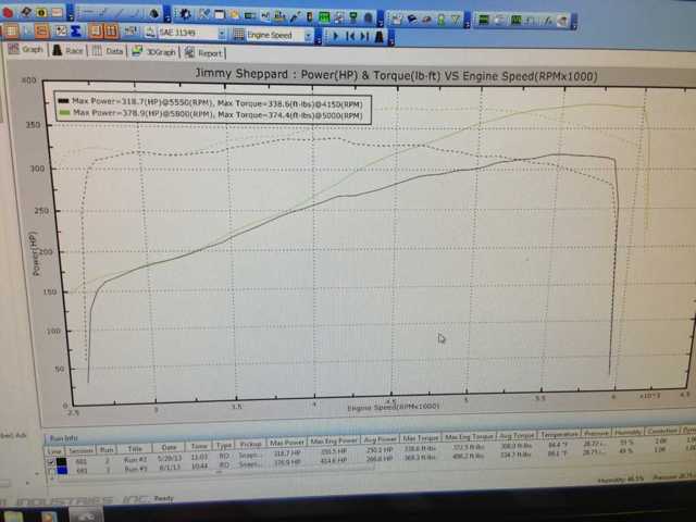

This was a 2012 challenger with a 6 speed. It made right in line with what the 6 speed cars make on our dyno as a baseline. I think I could get a touch more out of it, but humidity is obscene today. I just thought I'd share since there's been a bit of debate as to the worthiness of a 6.4 cam swap. qyqa9upa.jpg

Is this with or without the phase limiter?  Great job.
  • 6,042 posts
Look at the difference up top...  wow.
11.87 @ 117

Cam and springs with a tune. Surprisingly easy tune too. No lockout. Subtle timing changes. Air fuel at 12.4 across the board 92 degrees at 50% humidity.

If this is without the limiter, perhaps we can put the nail in that coffin.
60 dollar cams rule!
Nice job.

Stock cam phaser

It started loosing torque. Timing isn't always a matter of how much it will take. It's about what it likes.

No loss down low. I like it when companies say "that cam is too big, you will need allot more converter because your going to lose all your torque. This one lost nothing and gained a ton. Thats amazing. Cant wait to see what our VVT 410ci stroker with Thitek heads and custom grind VVT camshaft does for you guys.

Me too. That one will be fun. I was amazed by the pickup on this. I'm going to put one in my 300. I need some heads too.

So isn't there only a 100 hp difference between the 5.7 and the 392?

I tuned it
The rest is cubic inches and heads. Notice the 60ish ftlbs of torque missing from the 6.4
