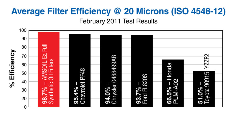

Dudes....ya gotta check out the Amsoil Filter.... PWR approved!!!
AMSOIL Ea Oil Filters (EaO, Ea15K)
Ea Oil Filters rank among the most efficient filters available for the auto/light-truck market. When used in conjunction with AMSOIL synthetic motor oils, AMSOIL Ea Oil Filters are guaranteed for extended service life:
Find the Filter That Fits Your Vehicle
Master Filter Cross-Reference Guide
Absolute Efficiency
Efficiency is the filter's ability to capture contaminants. The more efficient a filter is, the more contaminants it will remove from the oil. AMSOIL Ea Oil Filters have one of the best efficiency ratings in the automotive/light-truck market. Ea Oil Filters provide a filtering efficiency in accordance with industry standard ISO 4548-12 of 98.7 percent at 20 microns, while competitive filters demonstrate efficiencies as low as 51 percent (see graph).
