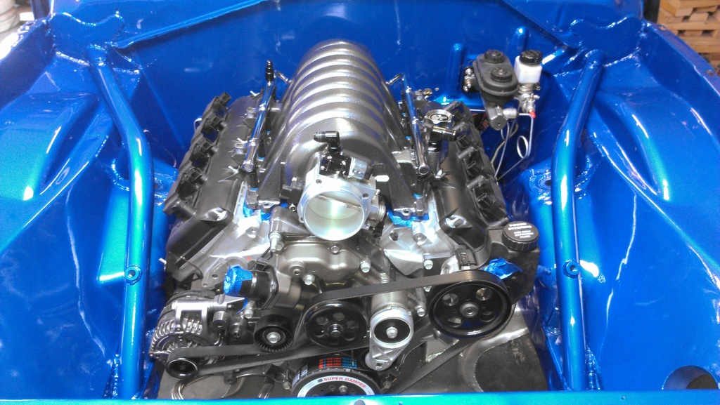

Bringing this back up, still slinging water around during basically 6500 and up. Any of you guys with built engines spinning past 6500? I shift at 6800 and can remove my hood and drive my Dart for testing. Stock 6.1 car water pump and front cover setup. Just about like clock work at 6500 ish I get a mist of coolant on the windshield. Cannot see leakage any other way, havent pressure tested it yet though dont have a tester. Its already on its second WP at about 2500 miles. Do these pumps just shit the bed from to much RPM or what? This is a head scratcher, there was coolant under the bolt under the WP pulley and a drop on the belt at the crank pulley but the weep hole is dry and the snout of the WP is dry to. WTF again.

Stroked 6.1/420, ARP head bolts, stock head gaskets. I would think if it was a gasket my overflow tank would be full with the 18 lb cap. Rev limiter is set at 6800, it will easily go past that but not necessary IMO. Its coming from the WP area but nothing is obvious, doesnt leak when driving or idling or sitting. Plus the cooling system holds pressure after parked for a few days. Sucky type of deal, if I knew what to fix, I would. Who else on here is spinning theirs hard with a stock pump? I know of plenty of guys that spin them in drag cars but they all have electric pumps.

Its the fucking water pump AGAIN, that makes 2 OEM pumps in 2000 miles. Seriously considering just epoxying the weep hole shut. That is for sure where its coming from, both of them did the same bullshit. Bone stock 6.1 acc. drive EXCEPT, an aftermarket PS pump and an ATI 5% balancer. If I change pumps im done with the OE pumps thats for sure.
