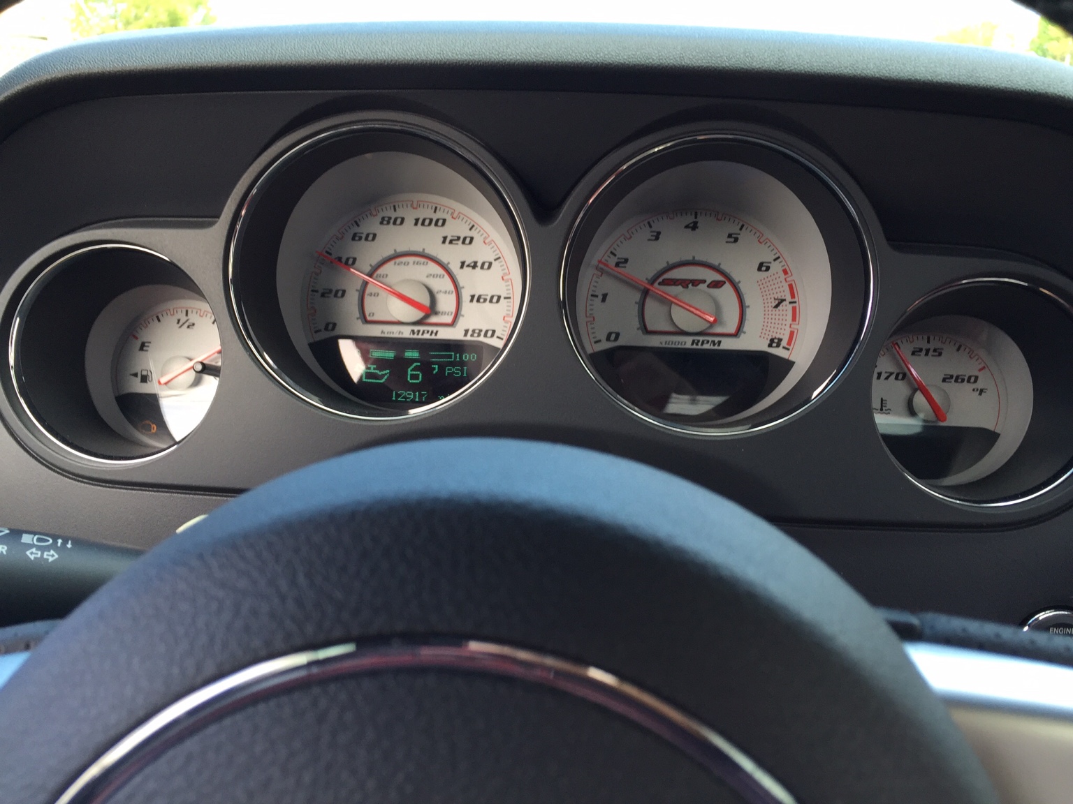

Jay, I always wanted to mount the light between the speedo and tach, in that little "upside down triangle" area up between them. When you took the dash apart did you happen to notice if there is room there? If so any idea on how to actually secure it? I was thinking of a rubber grommet of some sort.
Teddy
  • 15,173 posts
That's exactly where I intended to install mine.  There are two issues, one easily solvable, the other not solvable unfortunately.
There is a tab and mounting point right at the apex of that triangle on the back.  Easy enough to shave off.
However, the circuit board for the speedo runs the full length and width of that entire space.  There is no way to fit the shift light as cutting through the circuit board would obviously cause the instrument cluster to no longer function.  All the plugs for the cluster are across the very top.

BALLS!!!! Such a perfect looking spot too. Oh well. Thanks for the feed back. Guess I'll mount it to the double gauge "A" pillar cover too. Thanks.

i mounted mine in this location. its a magic spot where the light can be pushed in and it almost looks factory. its also easy to pull out when changing rpm settings. Its perfect for drag racing but if you need it for road racing wouldnt be as good. If you turn the wheel left enough you would cover the light.

i will try and find one.....i have a video so i can probably take a screen shot. and yea, I dont know about the differences between the big white gauge cluster package from your year to a '14 but in that area the cluster kinda looks like this....there is a bump up so you only have to put a hole in the snap on black plastic bezel. I figured even if I screwed it up, or wanted to return to stock, that piece cant be very much money
shift light 2
found a screen shot to use....not the best , but all I could do while at work
shift light 3

Well, looked at the dash again, and at least in my 2009 R/T that area to the right of the tach isn't viable.  There's just not enough room to squeeze the light in there between the cluster and the metal backing plate.
I'll be using the pillar pod.  If you don't have one of those, the a/c vent would be my 2nd choice.

What about above and between the tach and speedo, I know it's not a "flat" surface of angled, but with a thick enough grommet modified if could be made to counter the angle. All across that area left to right is open space? Though the pillar pod is prob an easier install
