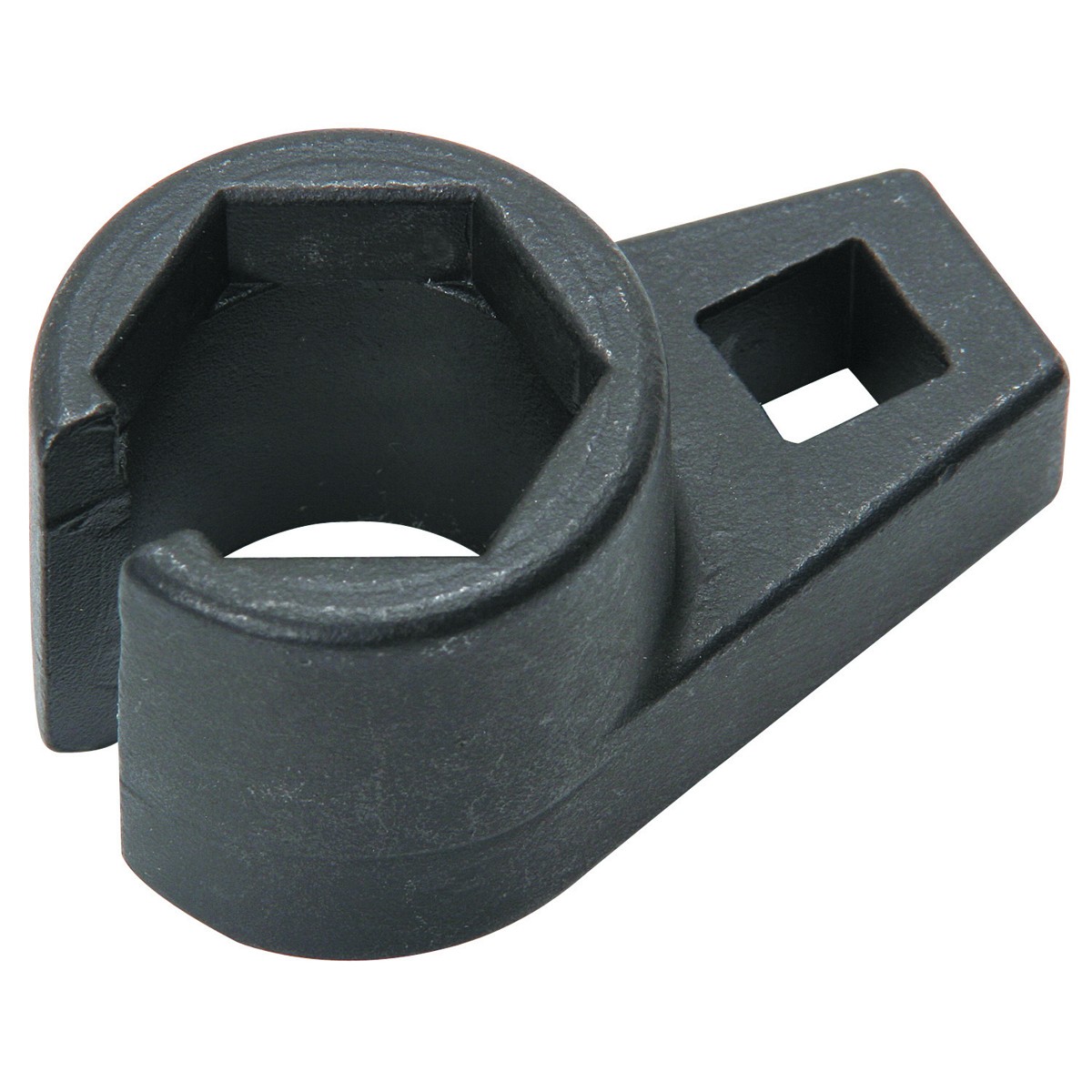

Not to keep beating a dead horse, but maybe I missed it. Is the only size of flex gear wrenches I need an 8mm? I saw a set at Harbor Freight for only $26.99, but they include only 10, 12, 13, 14 & 15mm.

Before you posted this, I had actually found an "O2 socket" on Harbor Freight I was thinking about picking up. With it, you just use your existing extensions, where this is a more complete independent tool. For the few dollars more I like this better.
Here is a link to the one I was looking at:
http://www.harborfre...ench-97177.html
