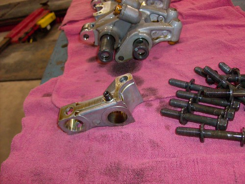

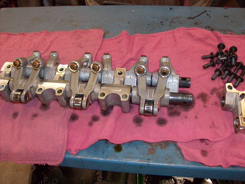

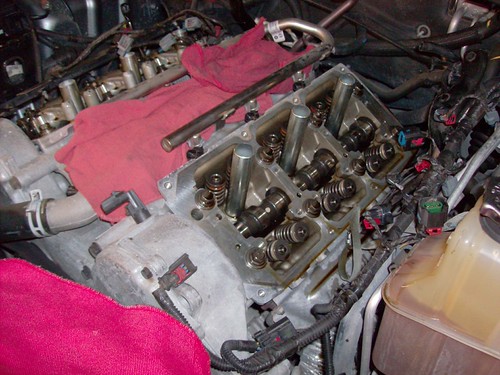

heh, it was no big deal really. i wish i had the foresight to have ordered the rocker dowels in advance though. for anyone that isnt aware, there are 4 locating dowels for the exhaust rockers, it keeps the shaft in position, and aligns the oiling holes in the shaft. if the pins seperate or break, then the shaft can rotate, and the lash adjusters fail to get oil, and tick....
pics.
3101686294_404b2f277f.jpg?v=0
3100850311_7019a55833.jpg?v=0
On those 3.5L's, always order 2 kits of the shaft pedestals. They come with the dowels. And always do the Exahust Rocker Shafts.
Here's some of my pictures of what happens to the dowels.
