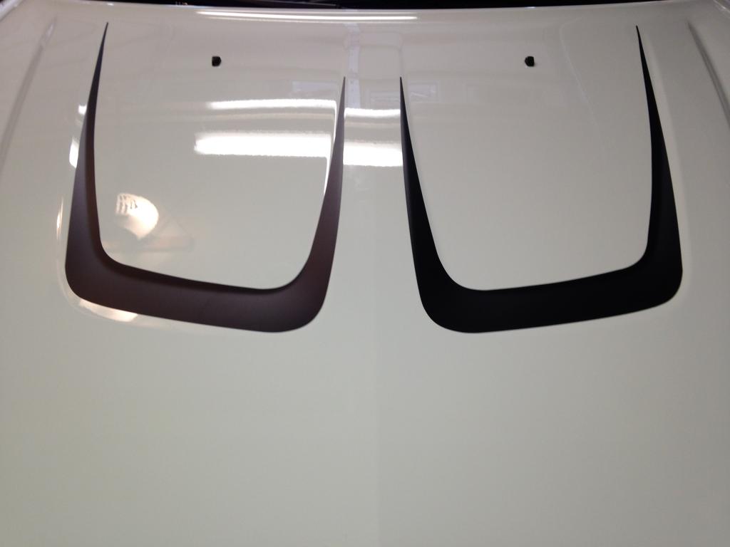

I've done some of the smaller graphics on my cars. I agree with the others on the wet method. My problem is I'm too stumpy to do a decent job. I used a local Tint and Trim shop to install my rally stripes. They have a large indoor facility and can do the work year round...... B)
