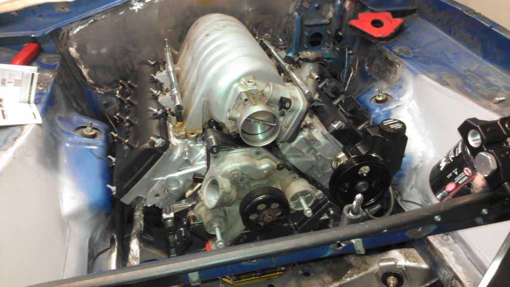

Im about to assemble this pig and am wondering if I will get some pinging issues with the 11.1 static this Manley 420" 6.1 may get. This whole time I was thinking CR would be 10.5 and I guess not. The cam will be one of Andy's old Comp cams with .600/.600, 247/255, 114lsa. Hope my static CR with go down with this cam? Pump 91 is as good as it gets around here. Hope I didnt create a detonation nightmare. I will be able tune to any timing I want to try to combat it. Dont want to need Race fuel to travel, maybe on the dyno or at the track but definitly not daily use. E85 im not ready to embrace just yet.
