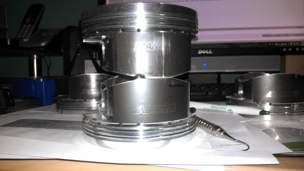

I went to great length to retain my squirters with a 4.05 crank. You can get pistons now with reliefs in the skirts for them from Wiseco and I think Diamond. My engine is gonna be beat to death on a Road Course so I know they will be a benefit. A strip engine just doesnt see the constant duty enough to justify them, unless its a mile shootout airstrip type deal.

I agree Dave, I paid close attention to trajectory on mine and they don't hit the wall unless the piston is removed at TDC.
Even after the squirter mods I still had to add reliefs to the piston skirts.
