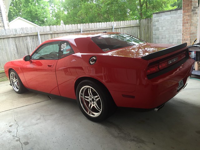

Love that look. Any pictures from the back or side profile? Do they stick out much?

Same setup John did for my car. It is tight as hell, but works. Had to roll the fenders and tighter the coilovers up. Best to use the adjustable sway bar links, but I don't remember if we ended up cutting mine or not. Seems like they were OK. My inner liners were shot anyway so cutting them a bit didn't hurt anything.

I wanted to do that on my 2010 soooo bad , bad to the bone ! Doesn't this require moding the lower control arms or something along that line Cam ?

Oh it's a ton of work K. Yes I build new lower control arms, then replace the shocks and springs with a double adjustable coil over that mounts where the stock spring goes. Then carve away about a third of the sheet metal upfront. I make 1/8" thick filler plates for the internal frame and new filler panels for the body. The bracing for the shock comes out too. It also gets a new filler neck for the fuel plus my adjustable end links to tuck the sway bar into the rim. The rim design requires a 4-3/4" front set and 8.5" back set. The fender lip requires a mild roll as well. All the new metal work gets seem sealed and everything is then under coated. I still use the Wel liner, but do a fair amount of rework to it.
Another words, it's a shit load of work. But it's so fucking cool. :)
Btw I built that one in 09/10. It gets beat on like you just can't imagine as the owner ain't shy about nothing. In 14 she came home for a couple upgrades and I tore it down to inspect everything to make sure all was good and well. There wasn't any evidence of fatigue to be found anywhere. That was cool and a major relief.
I did a thread on LXF that shows everything. I'll look it up the next time I'm on a real puter and send it to you.
