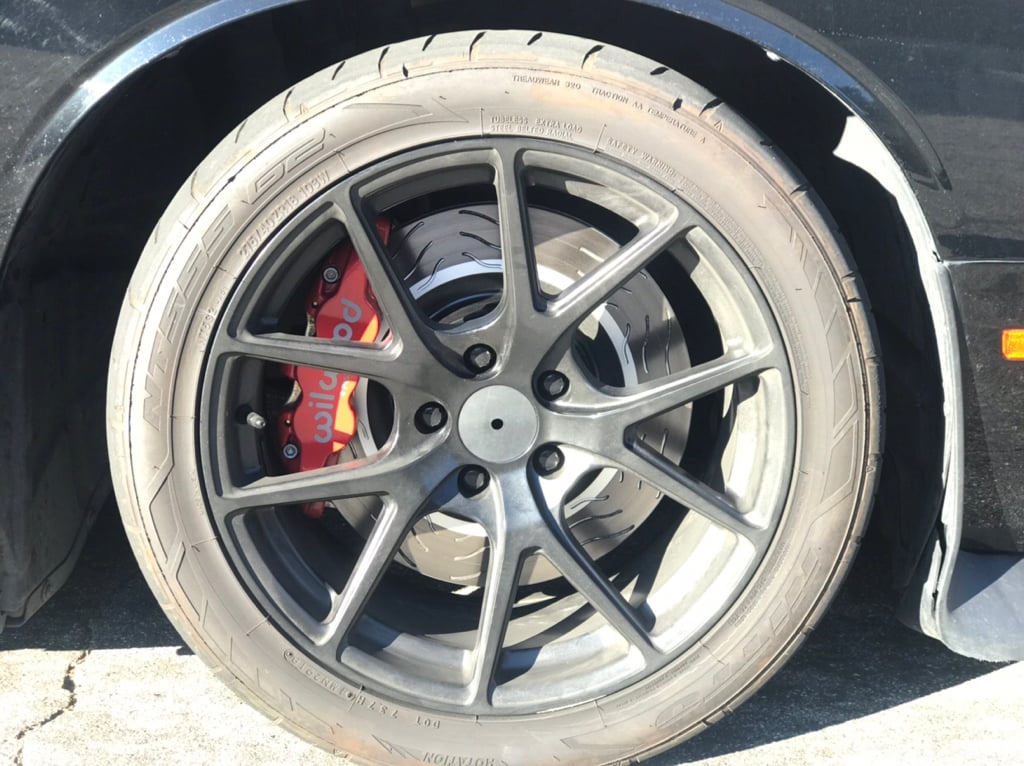

Baer makes a great kit, super high quality. Due to budget though, i went with a custom kit from TCE performance. No knuckle swaps, no fitment issues what so ever, and by far the most wallet-friendly option.
