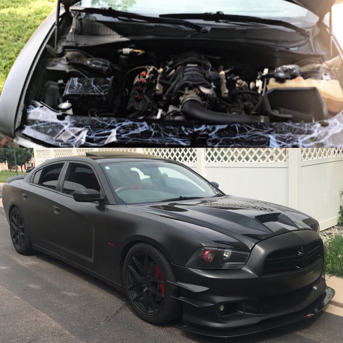

Well today my shop UnderPressure Power & Performance began stripping my car apart for the 392 Stroker install followed by a Twin turbo kit. I’ll be updating the progress on my build on both my pages Instagram.com/turbojigsaw and Facebook.com/turbojigsaw here’s a short mod list.
modifications
274 Comp Cam
Gov Delete
E85 tuned by “uppturbo”
Custom “uppturbo” Turbo-Back Exhaust
6.1 Ported Intake Manifold
392 Manley Stroker Kit
Triple Plate Billet Torque Converter
2 58mm Twin Turbo
80 lb Fuel injectors
Custom “uppturbo” Intake

Instead of a comp 274, why not do a custom grind specific for your application. I would think the 274 specs makes a terrible FI cam.
That might be something I changed later for now I was looking for a 10.1 ratio that will allow me to get thru the gears with ease especially in the mid to high rpm range. Also the cam was bought way before I decided to go the forced induction route.

Has there been advancements in getting the awd transfer cases to hold 500+hp?
If so, its about time someone put significant power thru an awd charger. Should be badass.

Yeah about that lol I’ve only known of one person I’m trynna follow in his footsteps
This will be a cool build...I actually was expecting the Demon to be awd especially after the release of the GT. What modifications if any are you planning on the driveline to hold the power? What kind of numbers you aiming for? And on another side note that front bumper is an agressive design! Who makes that?
Driveline nothing we’re looking at different options when it comes to applying the power to the pavement in regards to power transfer we’ve looked at possibly being able to disable the RWD while using the launch mode similar to what happens to the Jeep SRT when it launches. It’s undecided how it will handle the power, but the good news is the AWD on the 2014 Charger isn’t constantly enabled anyway. As far as the front bumper it is a bmc extreme customs srt bumper

Looking good...on a side note, the "Hemi" takes up some room doesn't it!
Yeah it does I’m going to have to alter my valve covers
