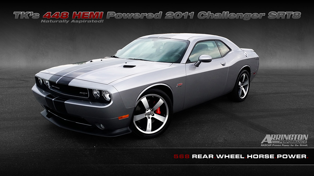

Yes, API got the motor installed yesterday and is hoping to dyno today. I ended up going to the Stage 1 6.1 intake and a 90mm TB and ditching the composite intake. I will share results as soon as I have them.
I'll post the video up here, Mr. TK, once its finished uploading. We just finished getting her all nice and clean for a few centerfold shots. ;)
Thank you sir!
