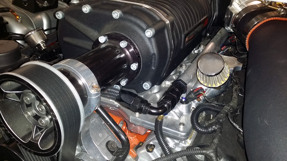

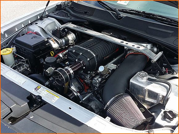

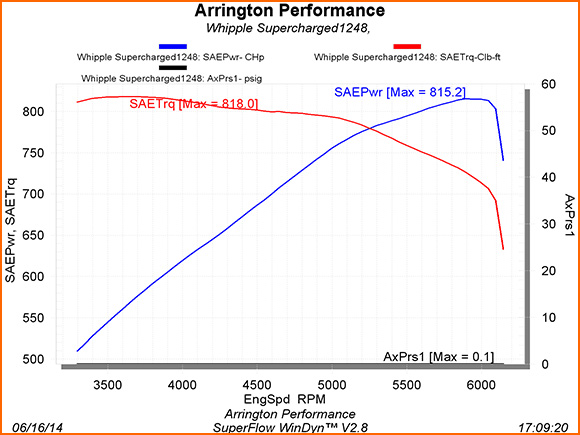

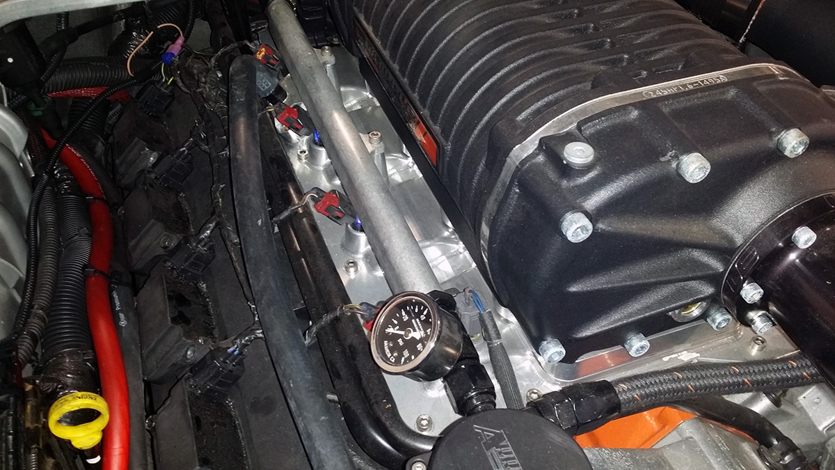

When Will brought us his 2009 Challenger, he had a VERY special build in mind. A combination of our Arrington Performance high-boost bullet proof 426 HEMI, Whipple Superchargers 4.0L supercharger, custom roll cage, and some major transmission/rear end modifcations to be able to handle the kind of power this thing is capable of. One of the coolest things about this build is that the monster 4.0L supercharger hasn't been specifically engineered to fit these HEMI powered LX/LC vehicles yet. This was not a problem. We designed and machined Will a custom billet intake manifold specifically for his application. Make sure and checkout the neck-snapping torque curve as this thing produces 815RWHP and 818FTLBS of torque on pump gas!
Underhood pics:
Dyno sheet:

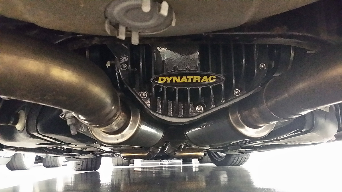

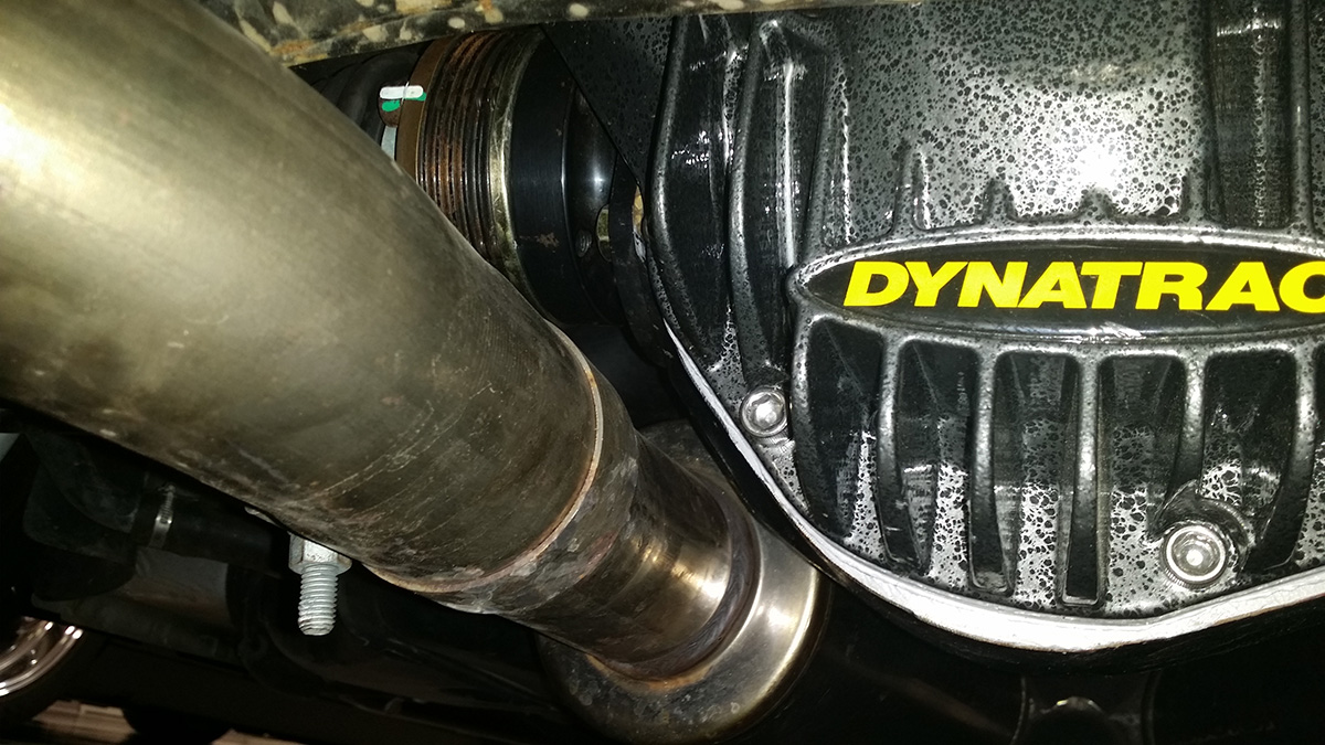

First Dana I've seen in the wild. What gears?
3.73. :)

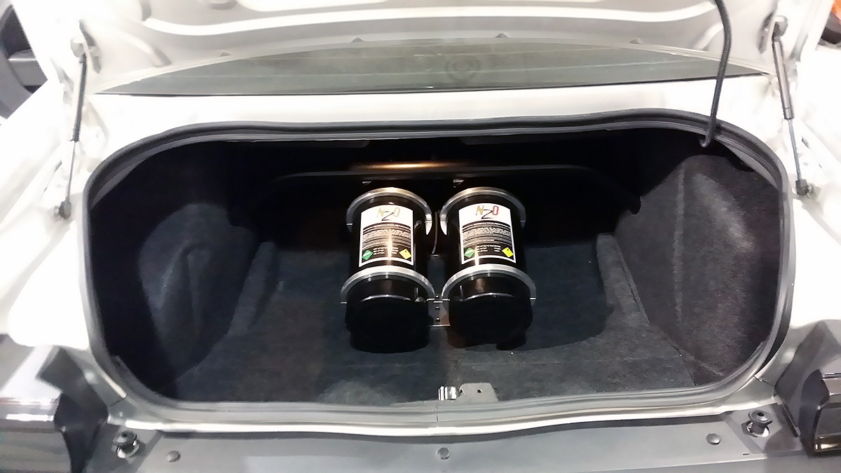

Dana 60 rear in there and nitrous!?
Indeed... 3.73 gears in the Dana 60 and dual stage 200 shot nitrous. The nitrous was NOT used in the dyno video.
Howbout some pics underneath her skirt eh? All of us would like to see some close up shots of that Dana!
You did take pics before it left didn't you?
Under her skirt, you say?? Let me see what I can do. ;)
