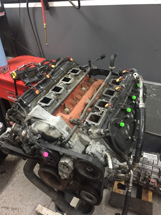

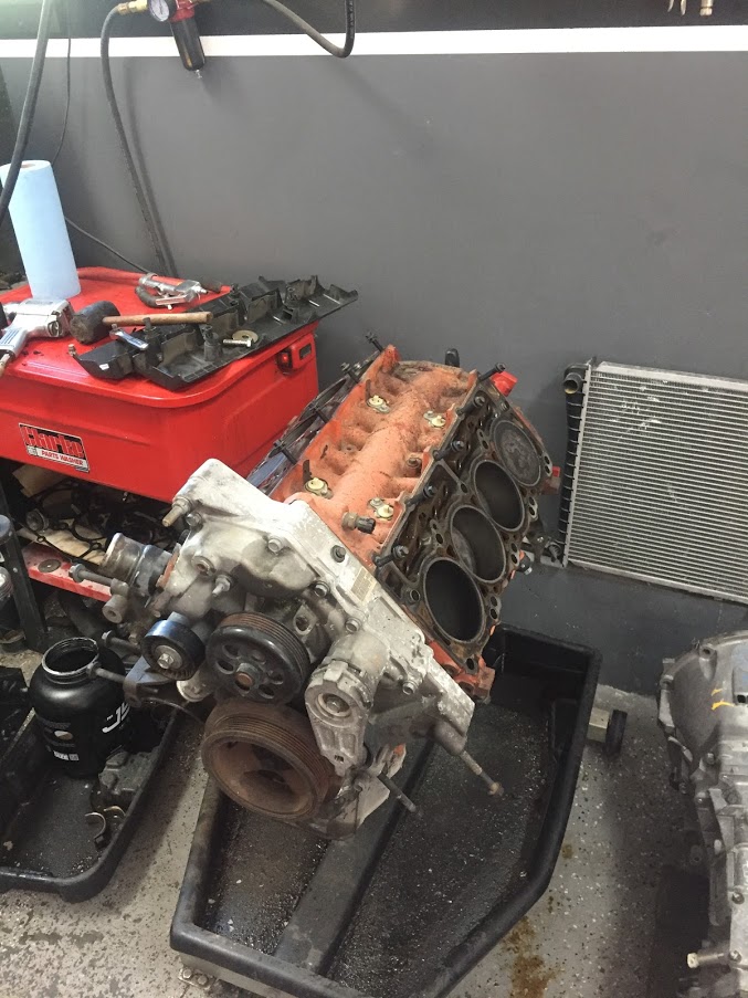

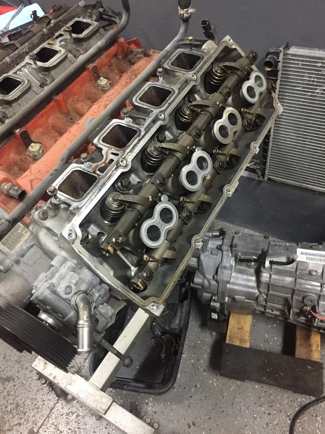

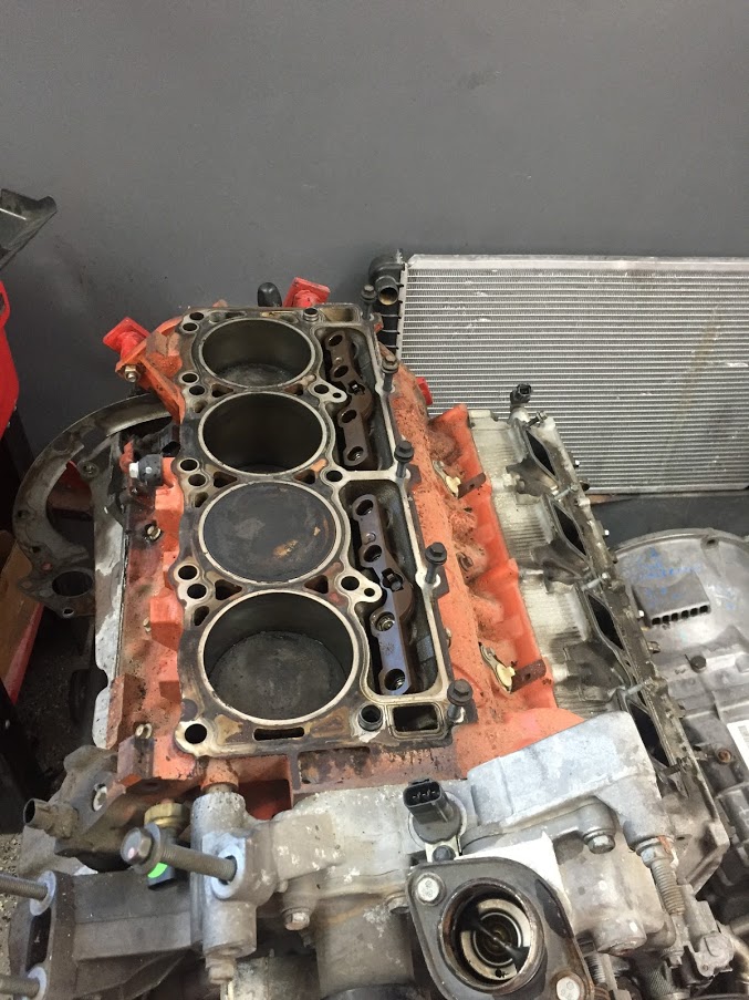

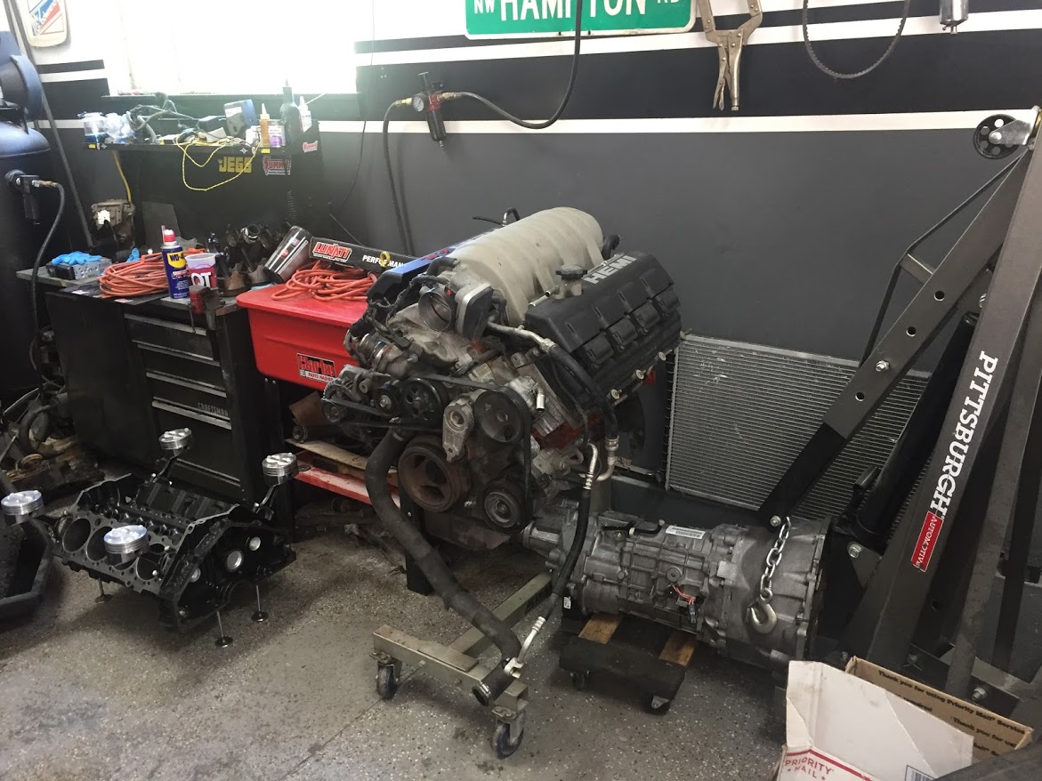

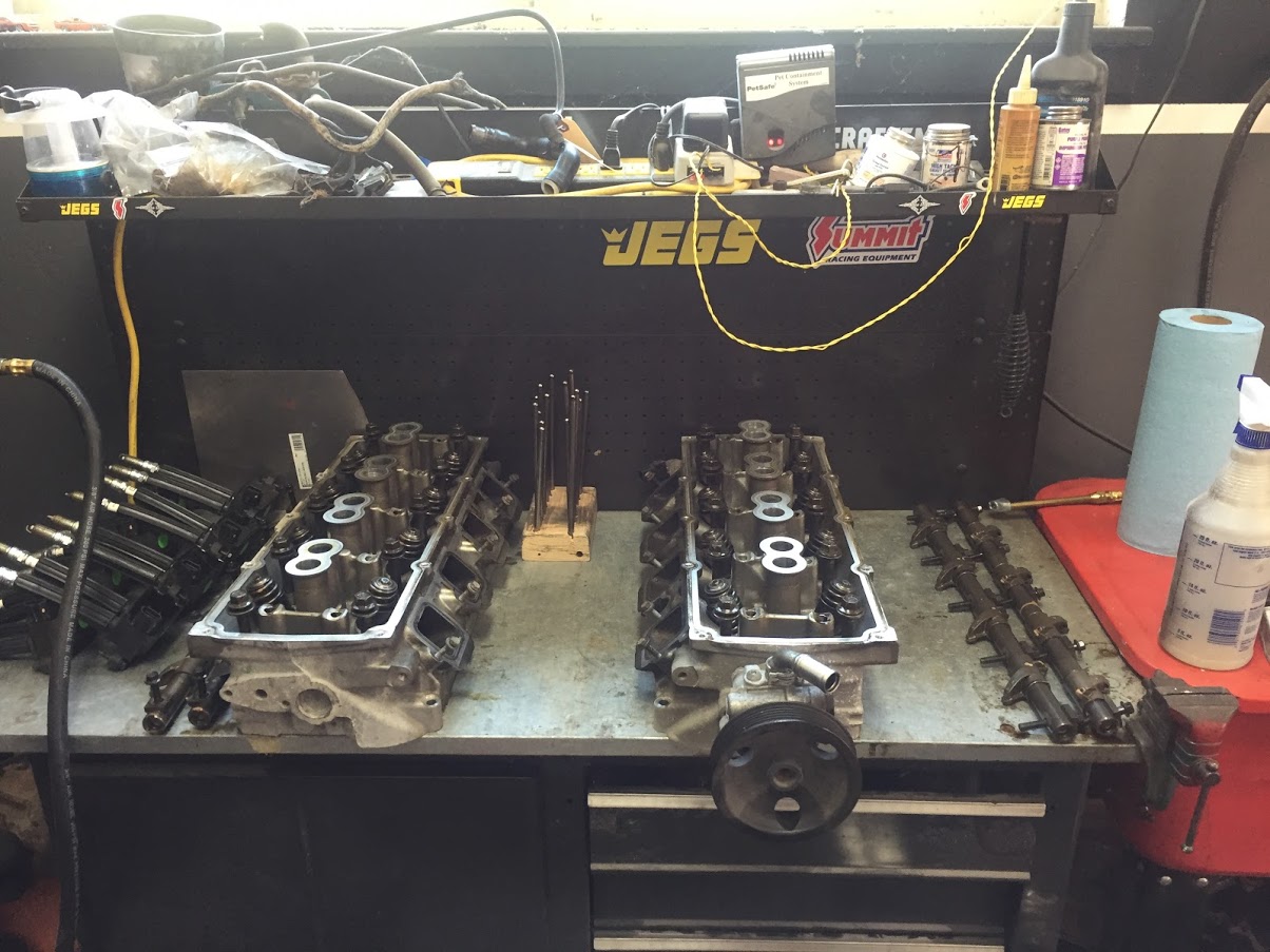

Here's how far I got so far, will pick the rest up when I get back in town
What are the black metal tubes going across the top of the block? Some kind of breather or vent tubes?
Also upon pulling the intake manifold bolts, I noticed the plastic pieces on them are borken/worn, any idea's where to get new ones?
1 hour ago, SmallBlockMuscle said:
Coolant runs through the black tubes
Makes sense, since they are coming right from the water pump housing lol
