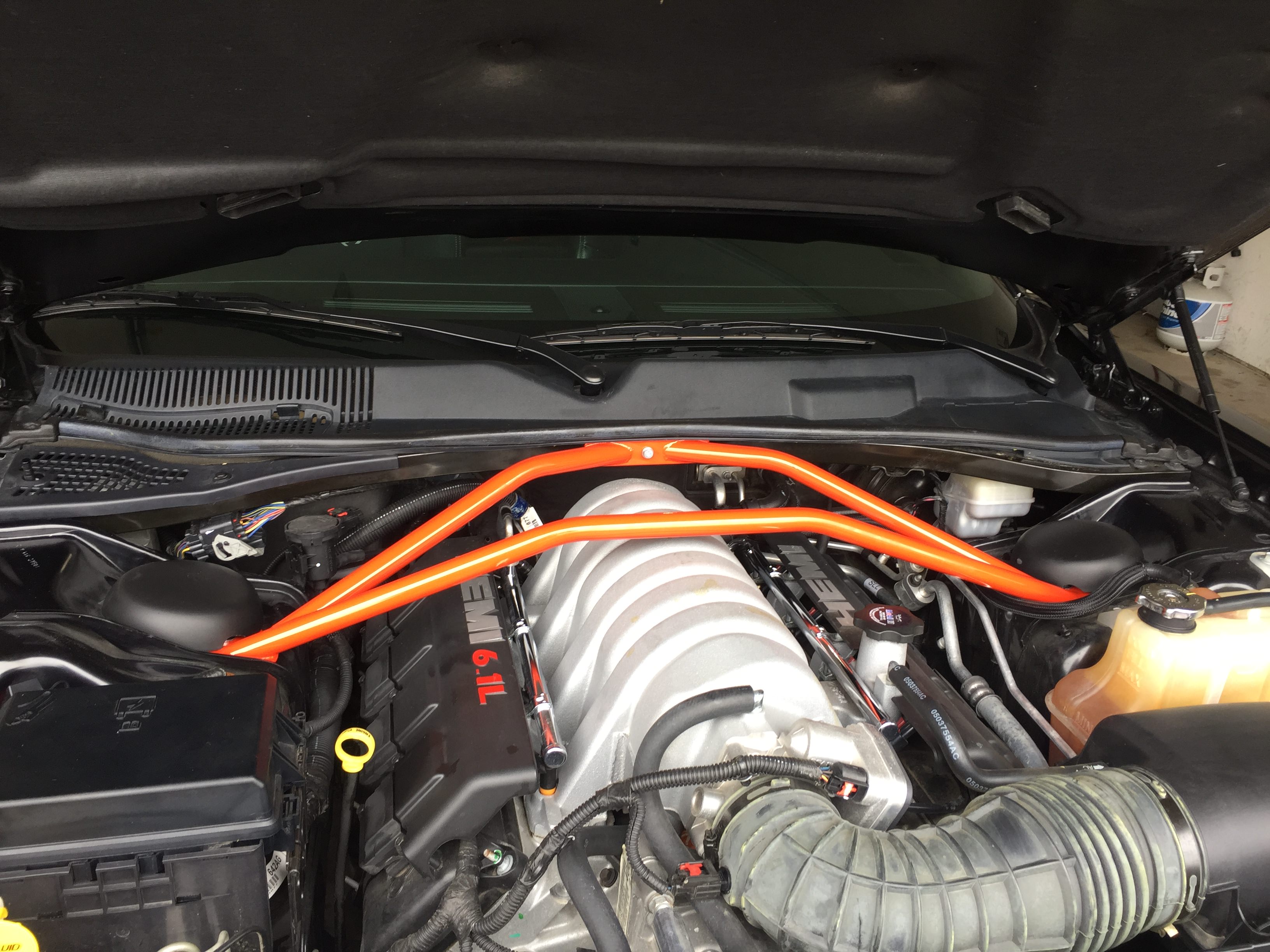

7 hours ago, Mopart said:
Would I have to loose my strut brace for the Kenne bell set up?
I think so. Unless you're road racing the car, the strut brace is not important.

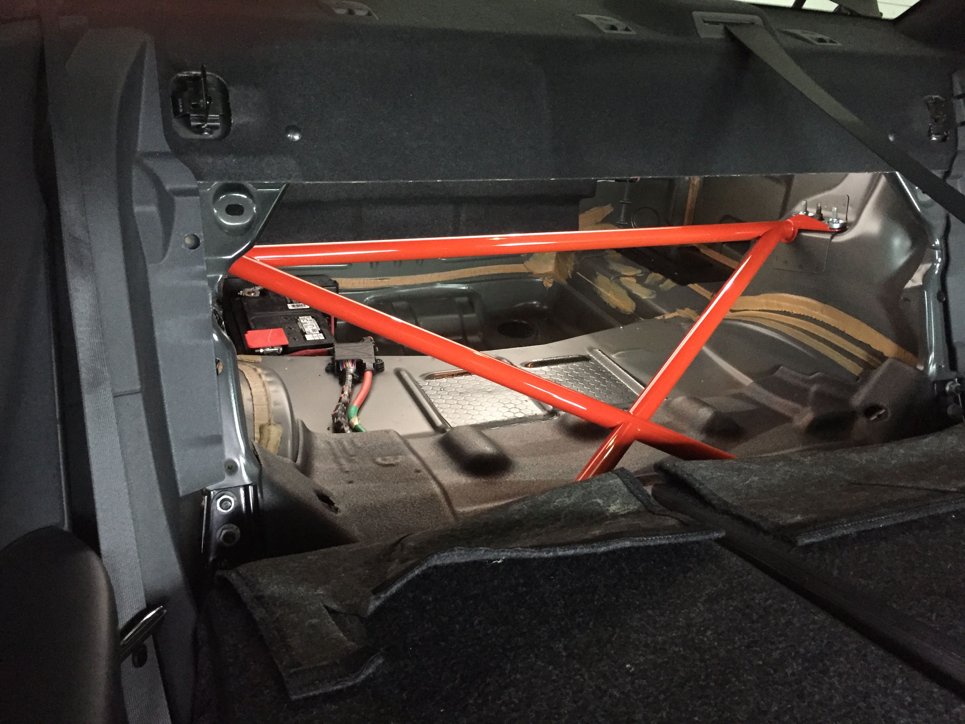

That's what i'm going with ... eventually. I went with the petty strut bar to clear the Whipple. Rear to matchSsSJlax.jpguYHM7d9.jpg
