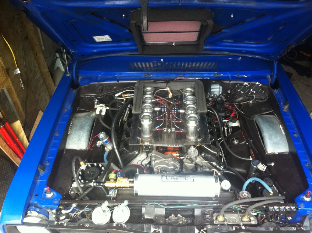

Pulled the 6.1, just swapped in a 6.1 based 392.
Motor Build specs:
4.055 bore, 3.795 stroke, 6.125 rod
Custom Wiseco pistons with lateral gas ports for spray
03-08 5.7 heads milled to closed chamber. flow 332 cfm at .550. (GTP)
Hilborn intake

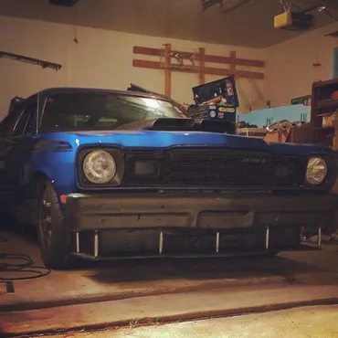

Thanks bud. They're not exactly pretty cars. Gotta hide the ugly.
I still need to chop down the front bumper to fit flush with the body. And do some bodywork to this new splitter/air dam. My fiberglass work is horrendous.
997B917F-BE1C-4DC9-8D32-6337569701AE_zps
The good news is it works great at keeping the nose down.

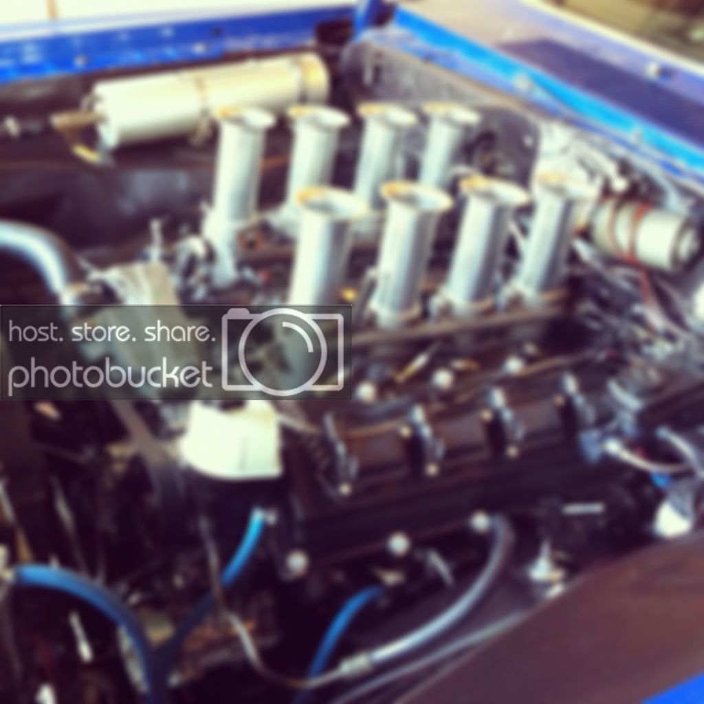

New motor is in. She runs hard! Need to rent some dyno time to dial in the tune. Maybe alex can get his started and we can do a dyno day.
Also- I flowed the heads with the hilborn on it. Lost 20 cfm give or take. I'm pleased with that. Still need to play with different ITB lengths- see what it does to the torque curve.
