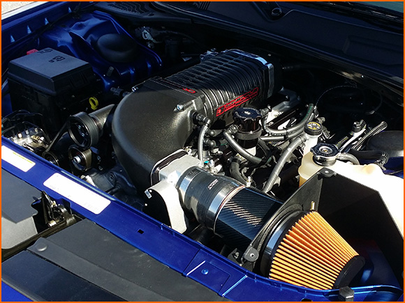

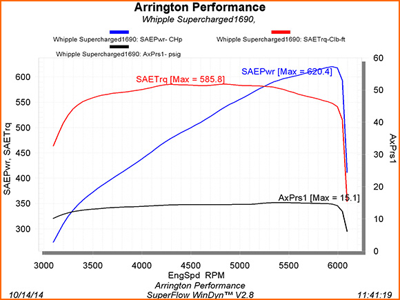

Another Whipple Superchargers 2.9L kit installed and producing some great numbers here at Arrington Performance. Using our forged 345 HEMI and custom calibration, this Challenger handles 15lbs of boost produced by this Whipple supercharger with ease. This 2012 Challenger R/T is now pushing 620RWHP and 585FTLBS of torque to the ground!
Underhood shot:
Dyno sheet:

You guys know I've been eyeballing a 2.9L Whipple. Is there any comparison to a Maggie at 15psi? I know the Maggie gets close to topped out at that point. The only reference point I have is mine made 550RWHP at 600RWTQ on your dyno back in 2010 at 12psi with the stock air box.
Stock cam in this beast?
