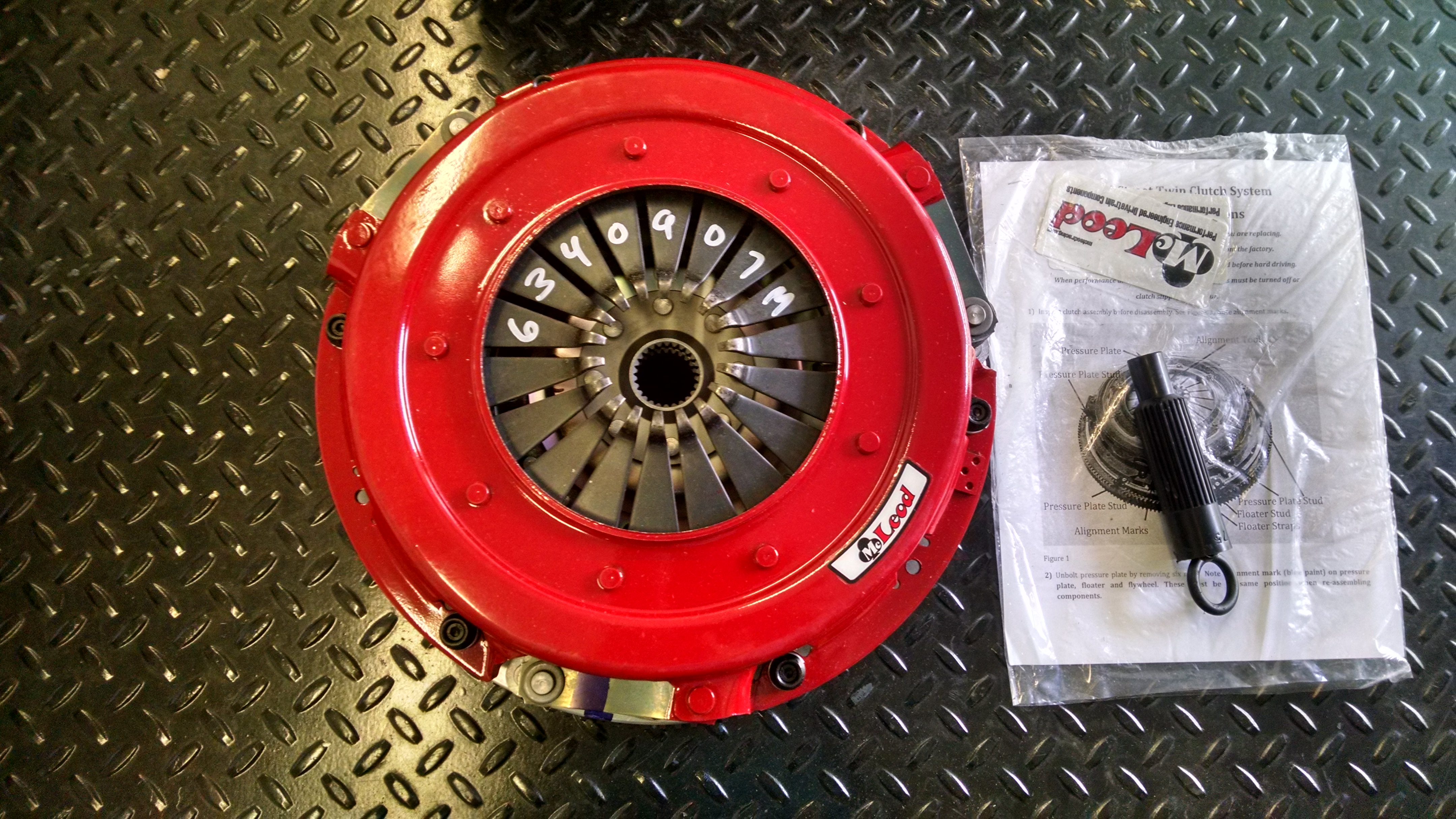

Next to be upgraded was the clutch. There were no shelf units available that would hold the power we required. A custom clutch and flywheel were spec’d and created by the good folks at McLeod Clutches.

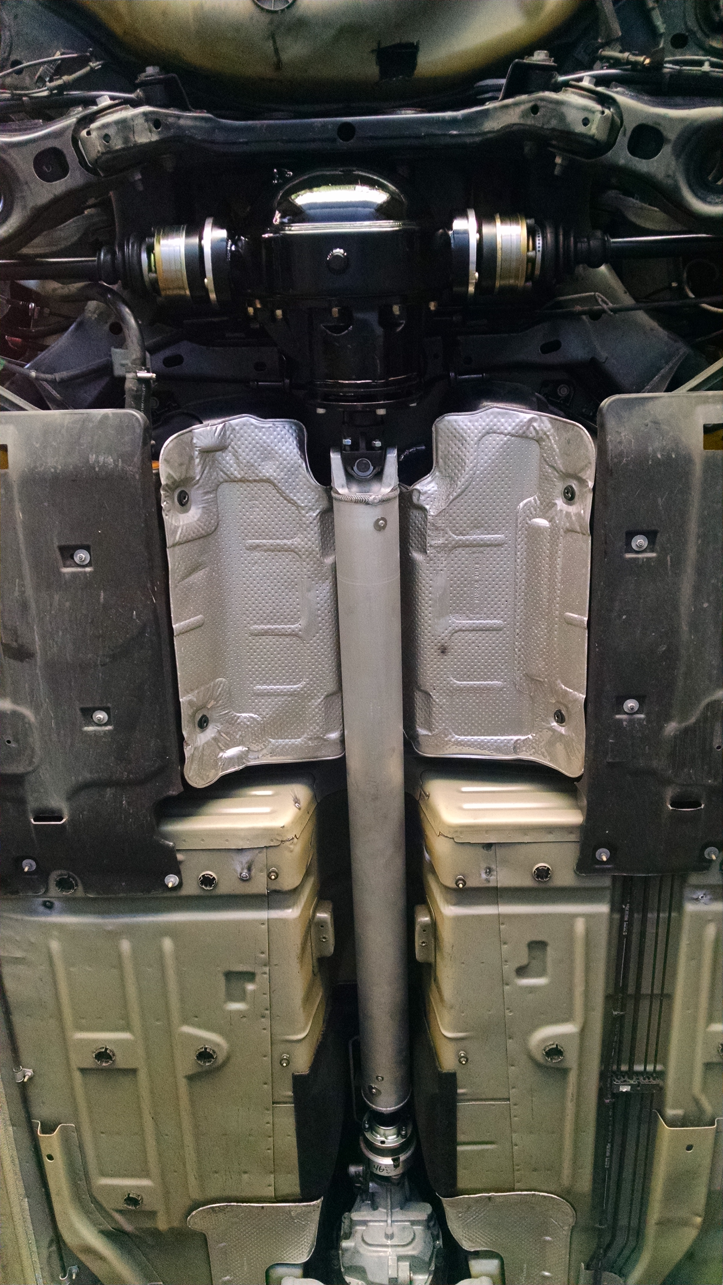

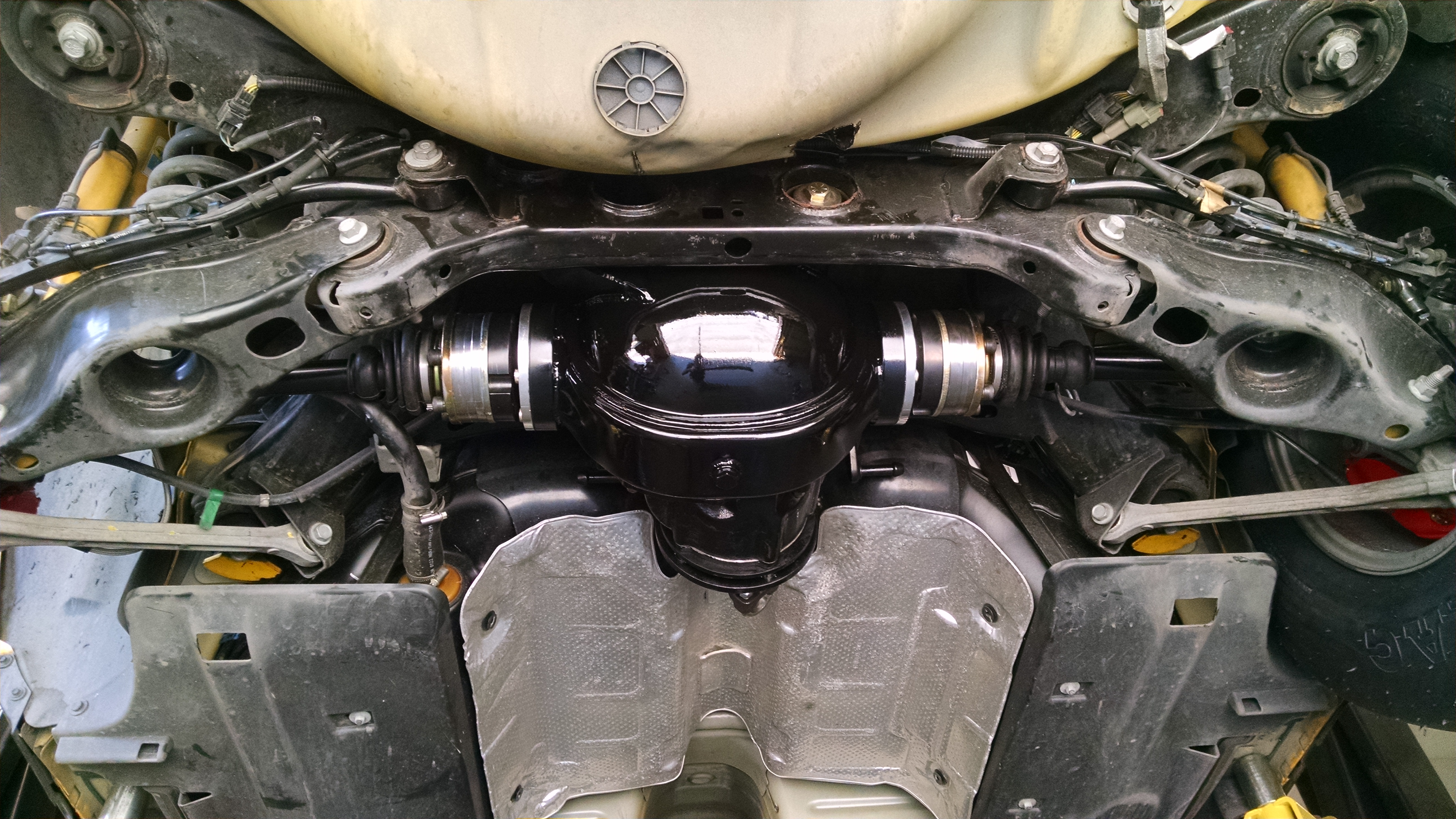

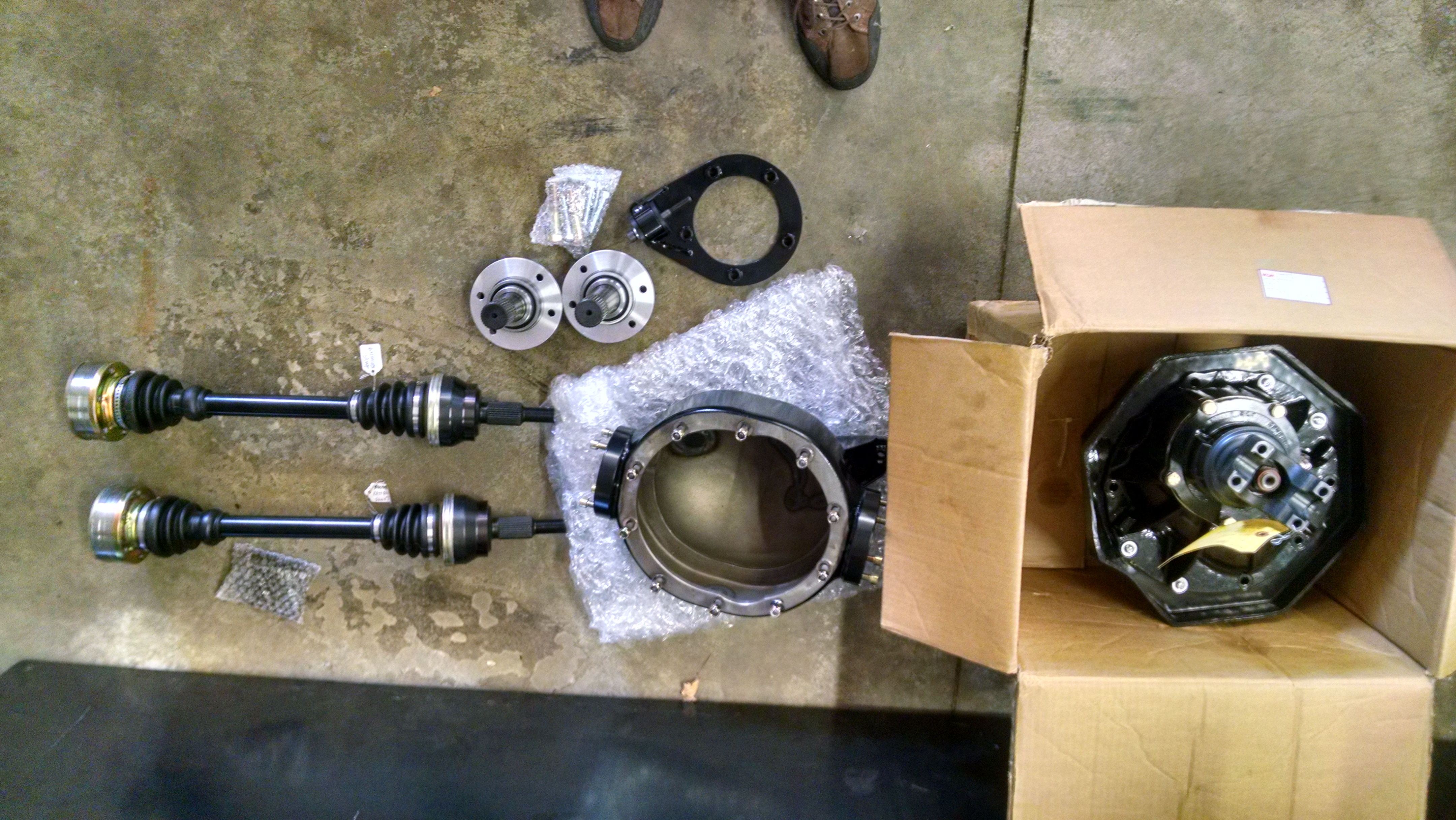

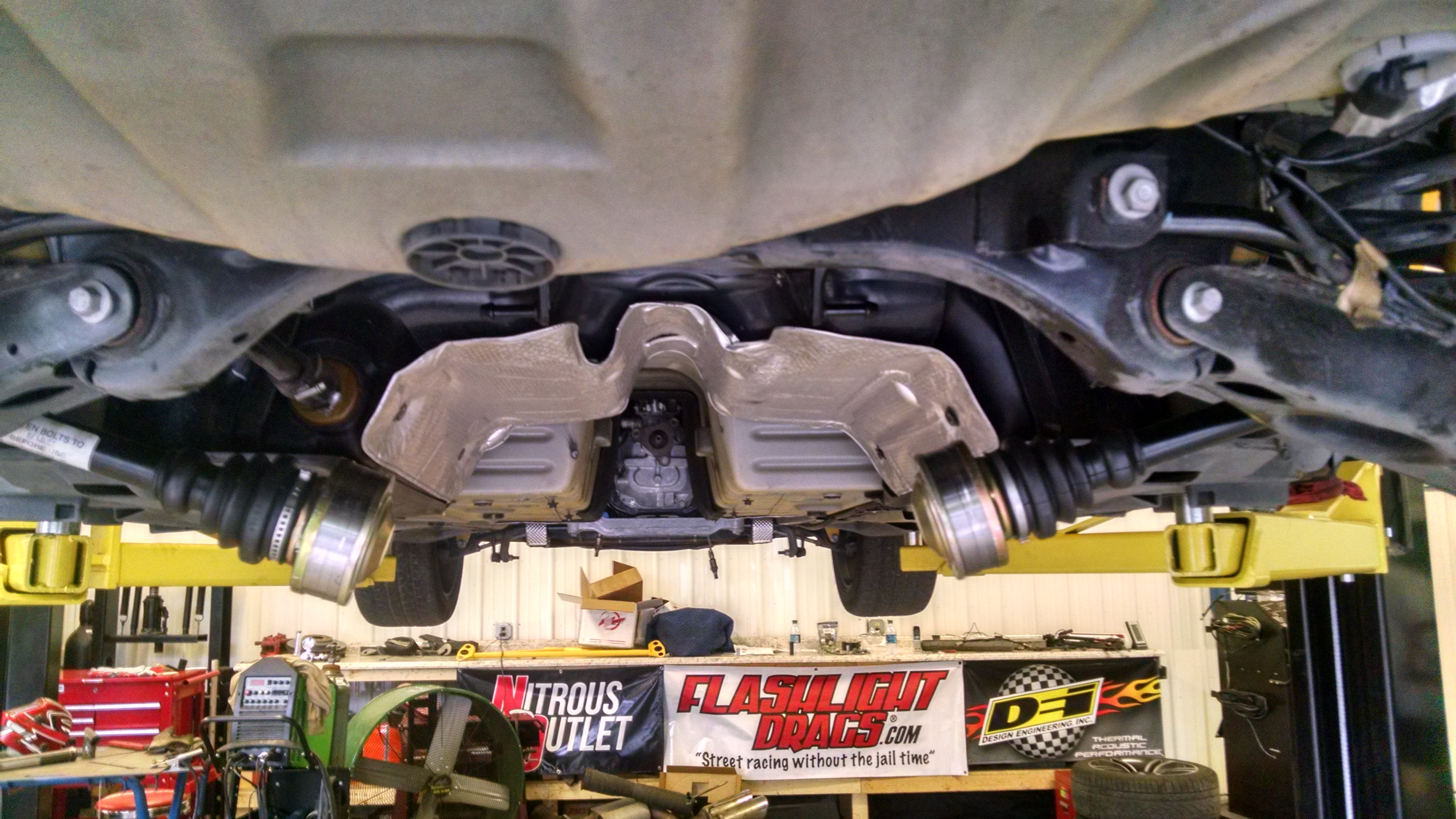

With the transmission and clutch upgraded to their full potential the only things left to address were the differential, axles, and driveshaft. After researching the available options we chose to use the Driveshaft Shop complete 9” differential upgrade kit. The kit is stated to be a bolt in ordeal but we all know how that goes!

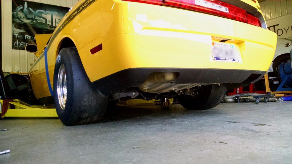

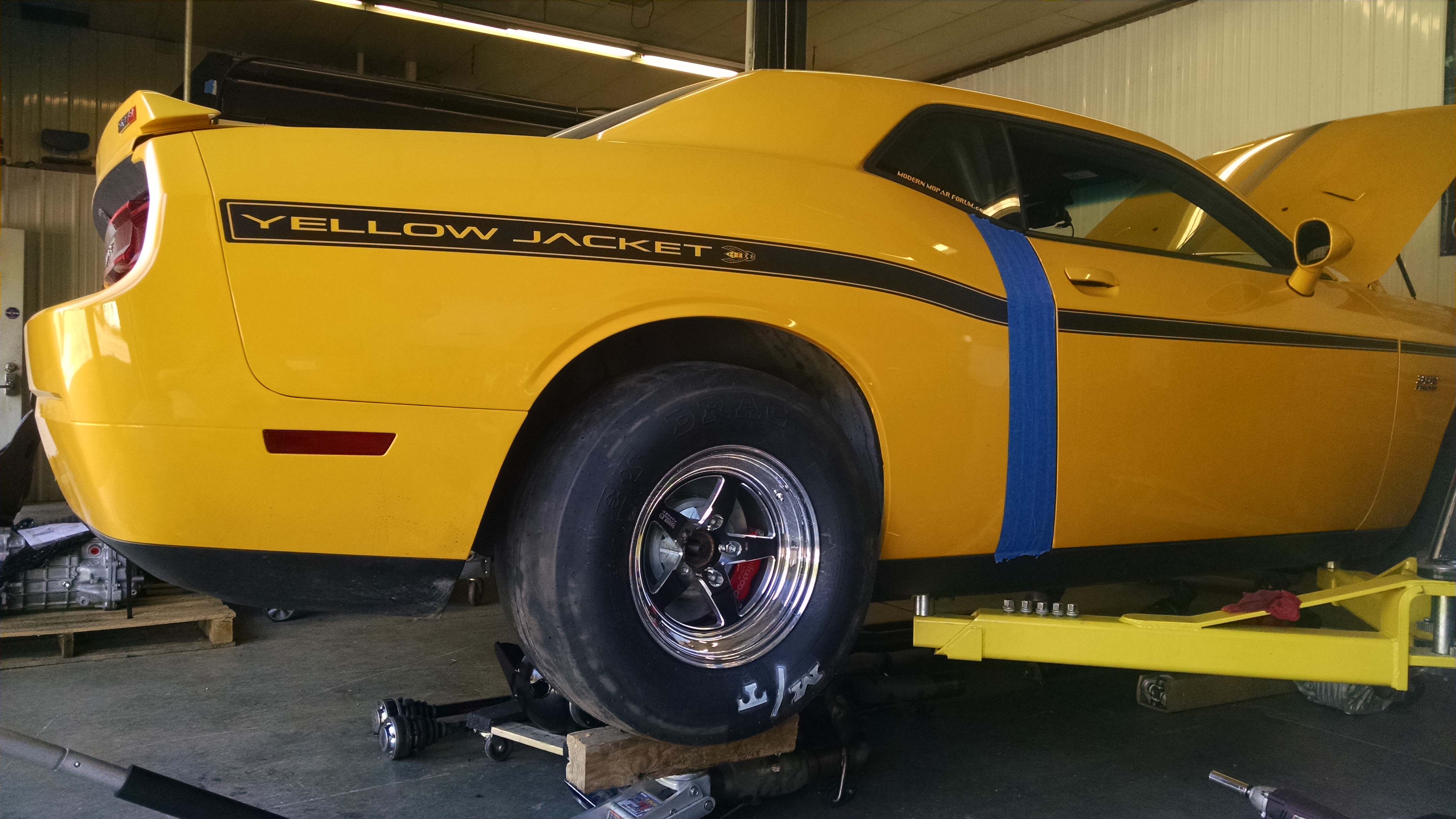

To put the power to the ground we chose to upgrade the car to 15” wheels by way of the TCE rear brake conversion. We picked out a set of 15x10 Weld wheels and 28x11.5 M/T slicks

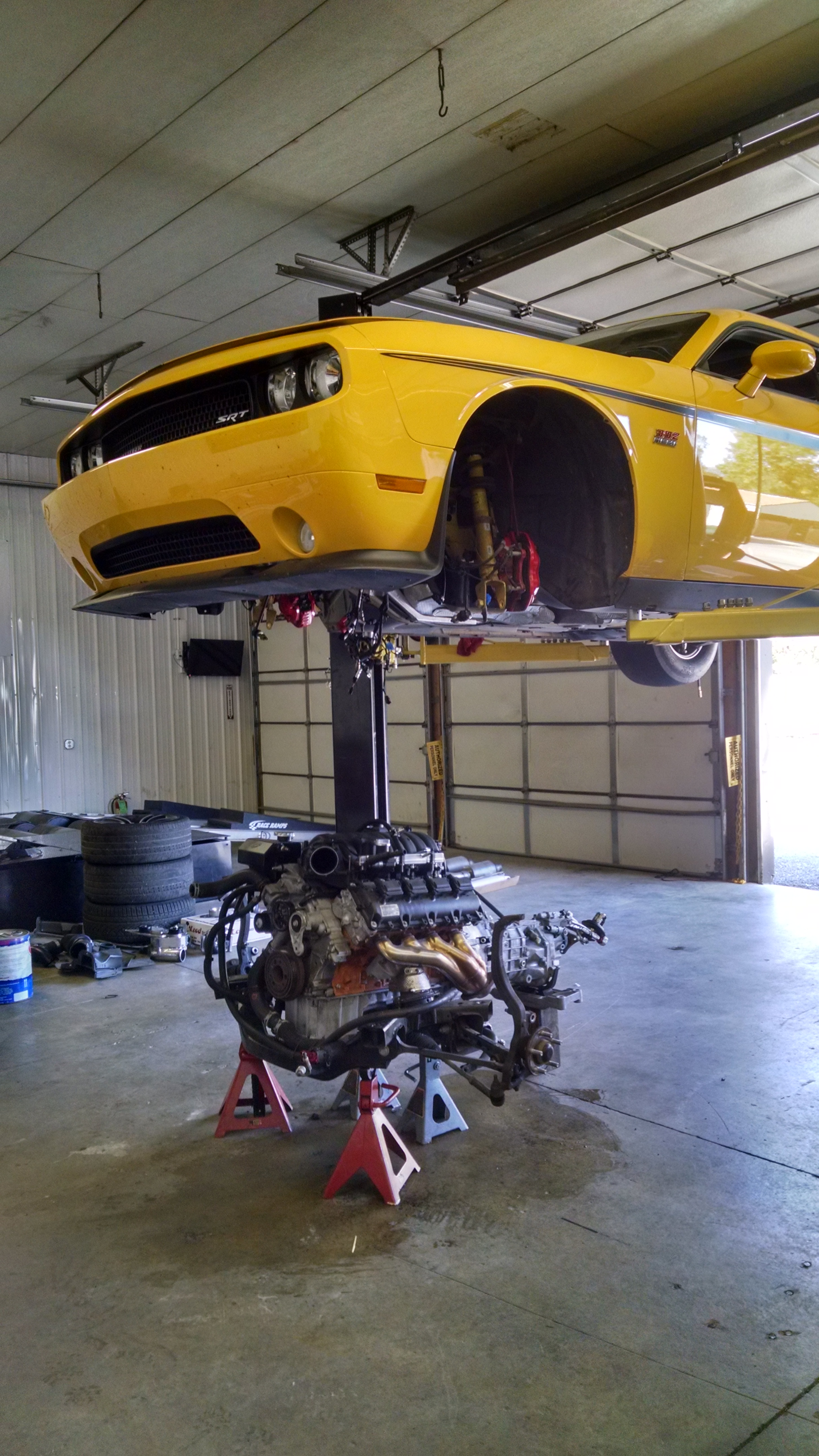

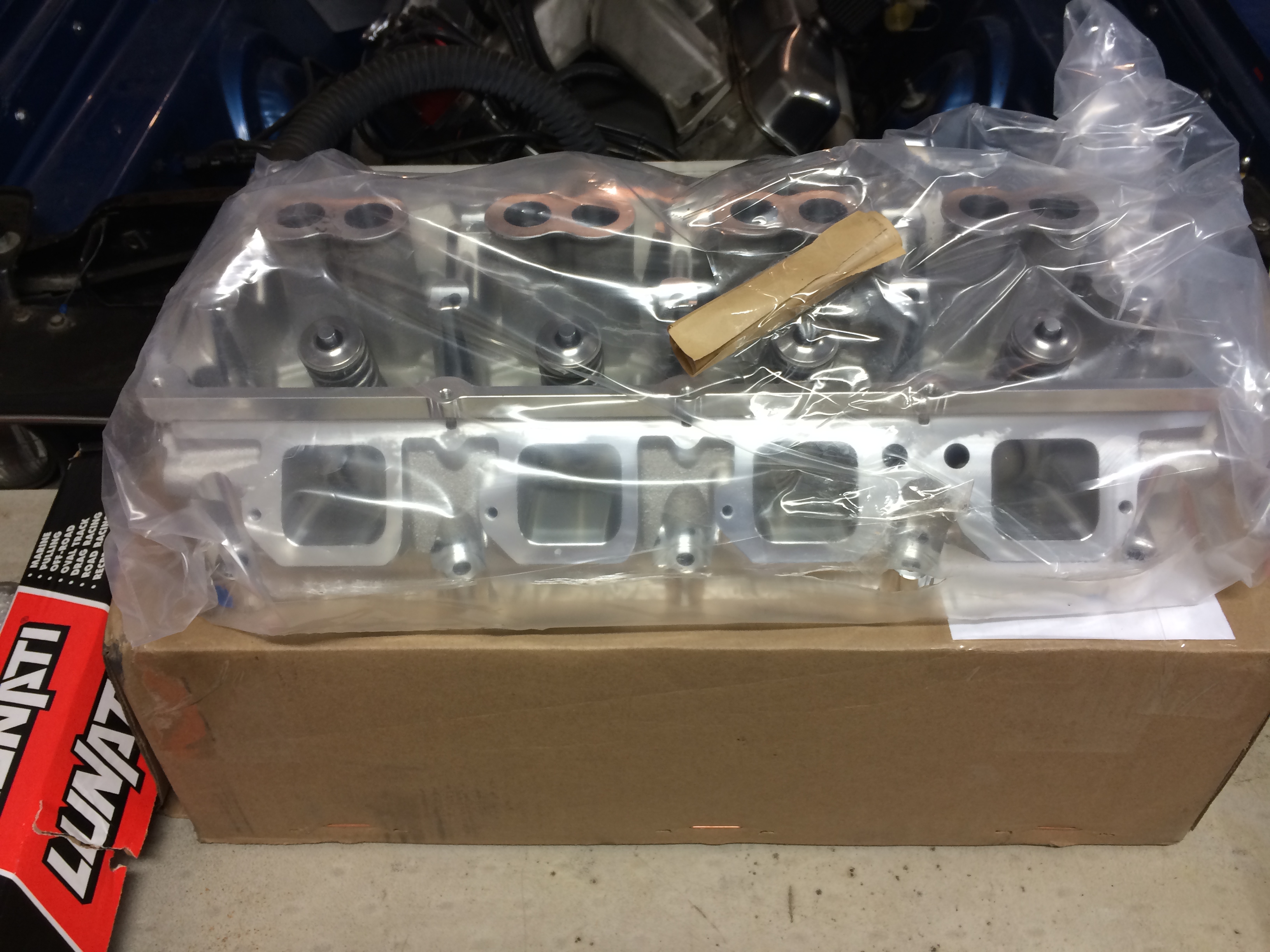

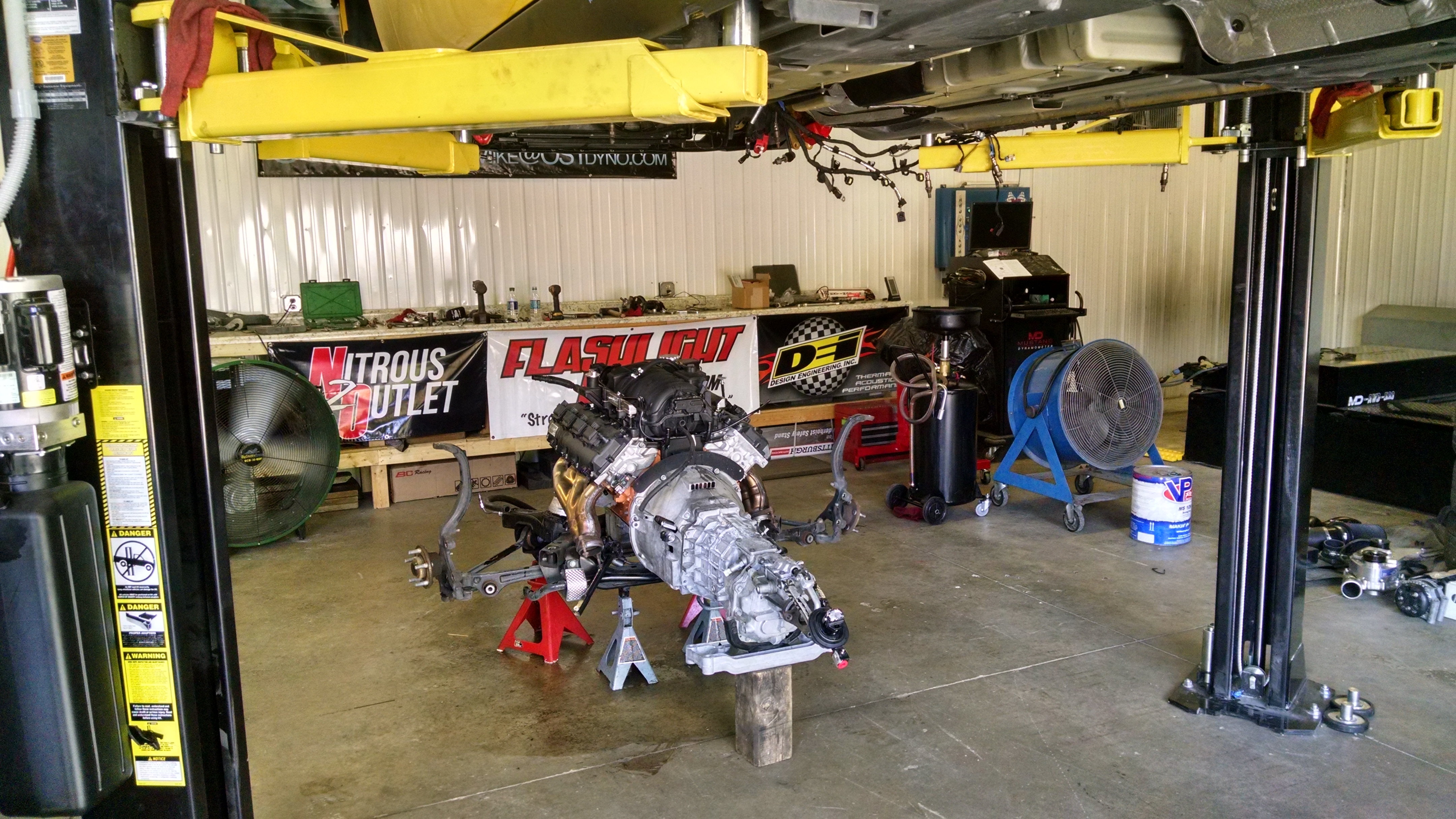

To provide the power needed to propel this 4,000lb car into record breaking territory a serious engine was needed. We of course went to the best of the best and spec’d a custom OST Dyno 426c.i. engine with a custom ground cam. This motor is built for, you guessed it, boost! Lots of boost. Would we do anything else at OST? We also upgraded the heads to a set of big valve Thiteks.

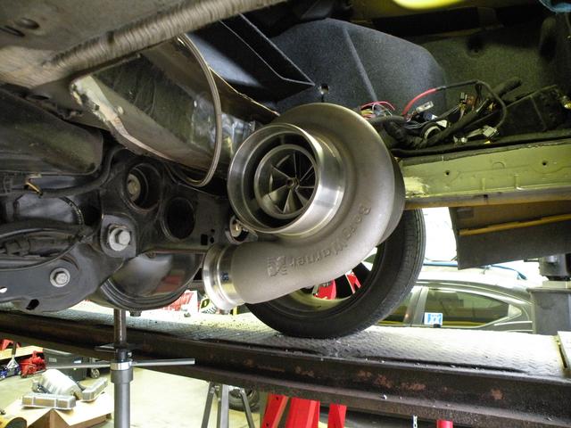

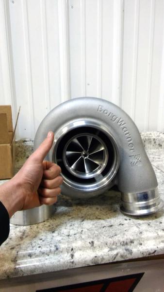

Lots of research was conducted and we finally chose a Borg Warner 88mm turbo with a billet inducer wheel. We chose this turbo because it would not only give us the power we needed but it would spool very quickly; something of a necessity in a stick car that has no converter slip. Even though this turbo is 18mm smaller than the turbo on our Jeep, it’s still massive!

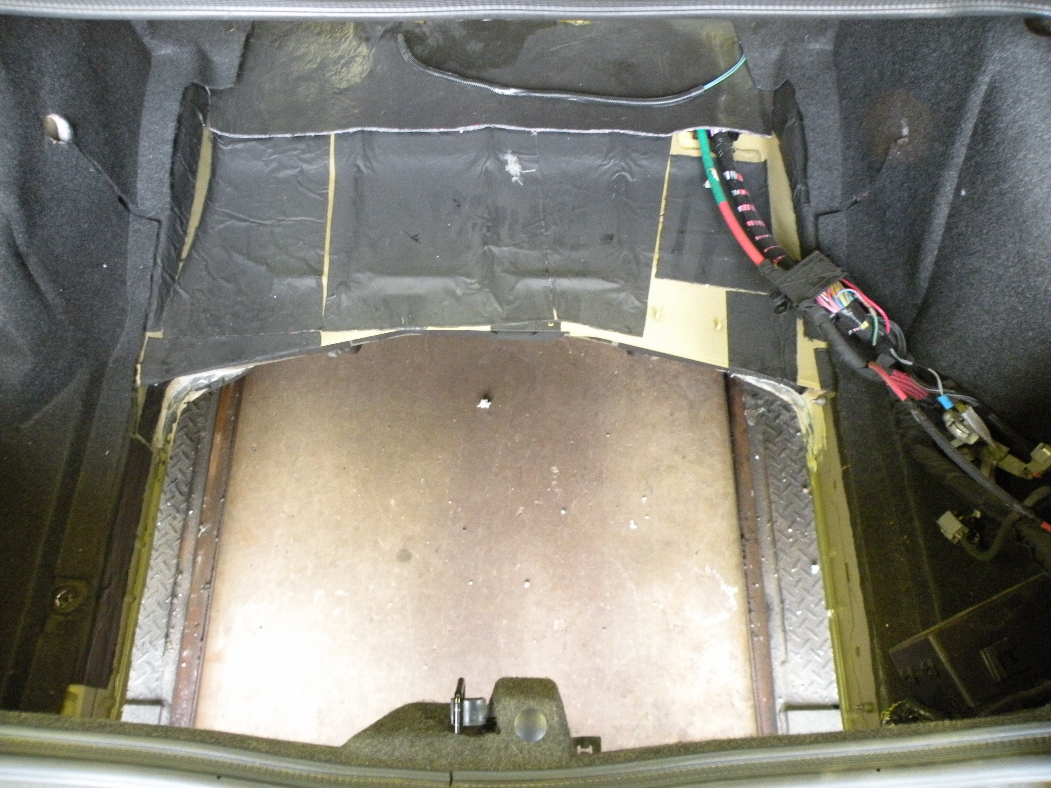

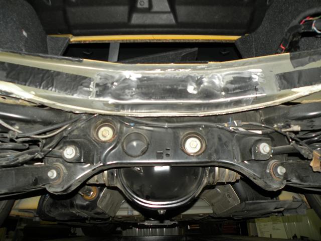

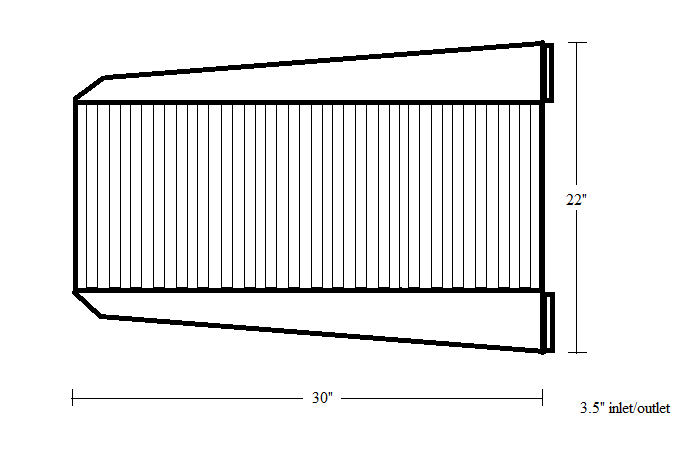

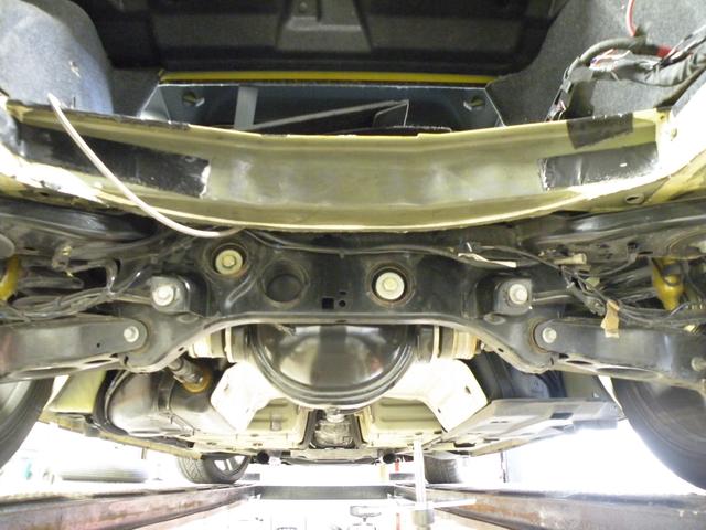

Before receiving the car we discussed both front and rear-mount options. However after getting the car on a lift, looking things over, and mocking up the different options it was clear only a rear-mount setup would be feasible. After planning out the routing of the exhaust and charge piping, ordering the required pieces and bends, and spec’ing out a custom intercooler, we got to work cutting.
hf9j9t4.png?1

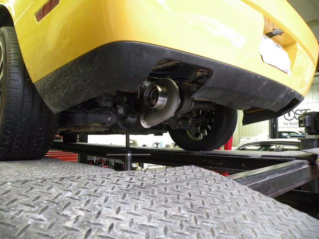

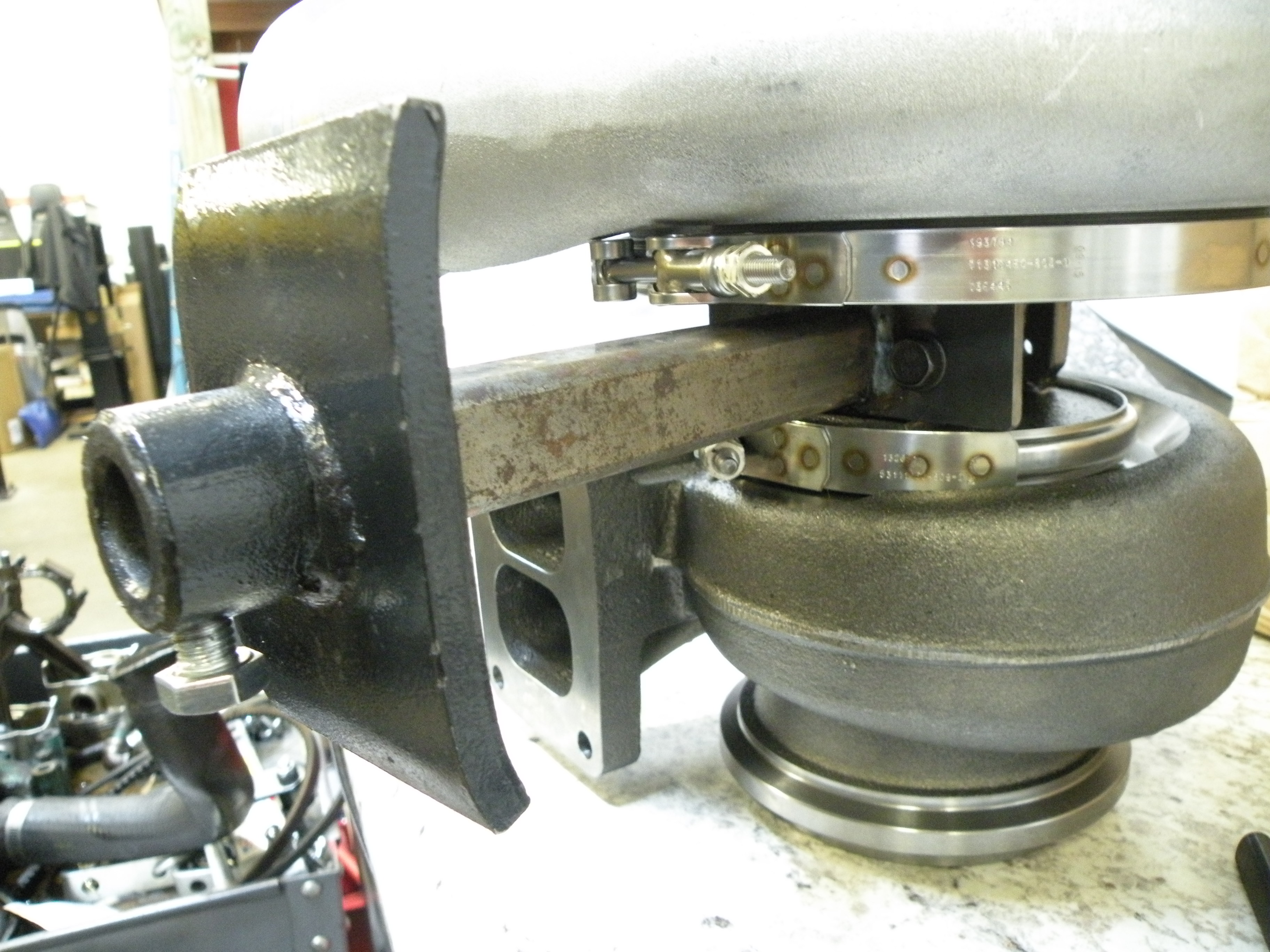

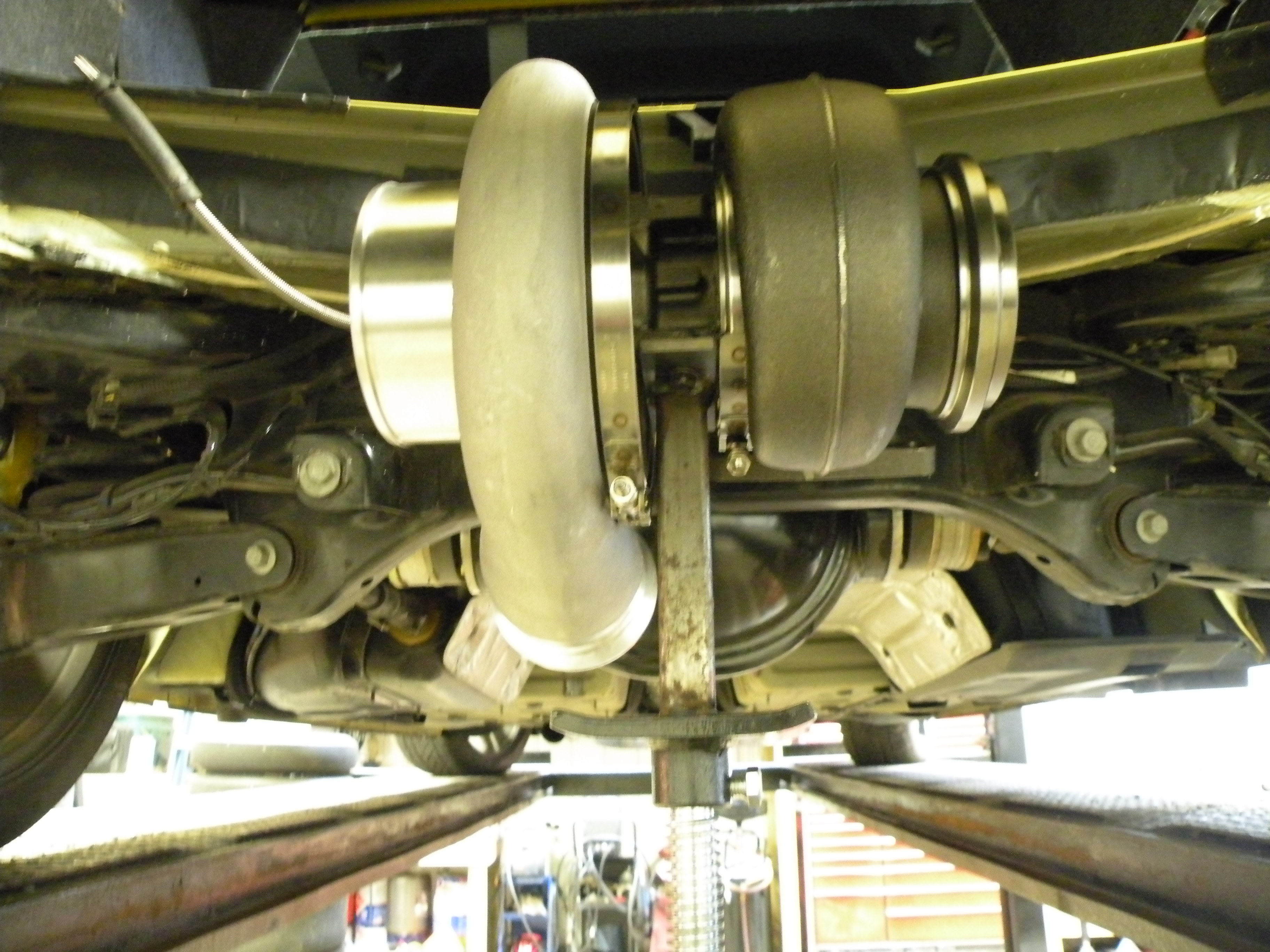

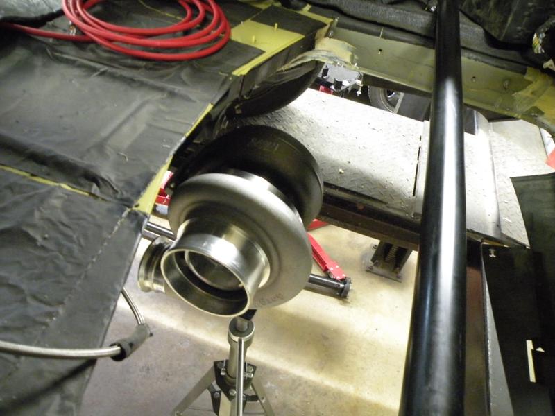

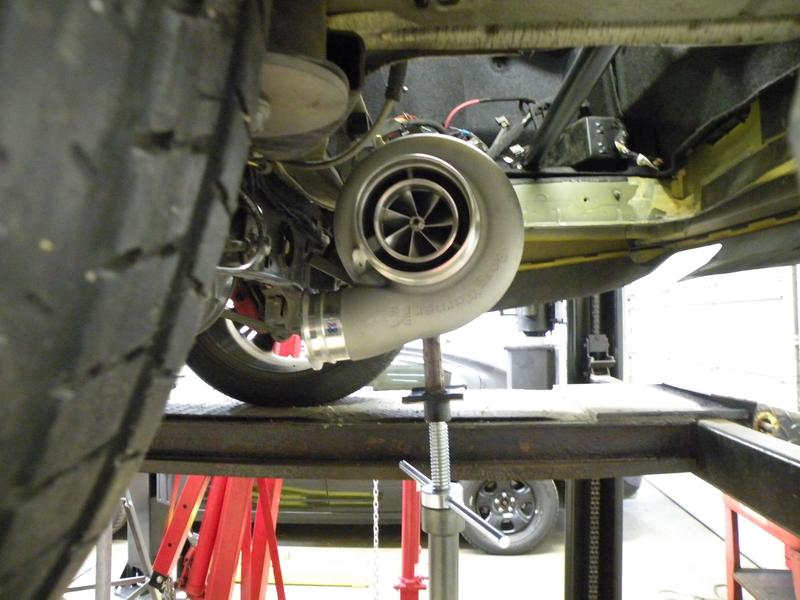

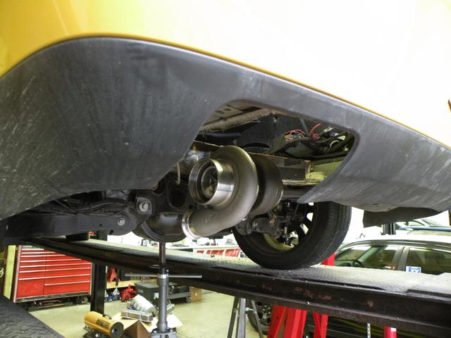

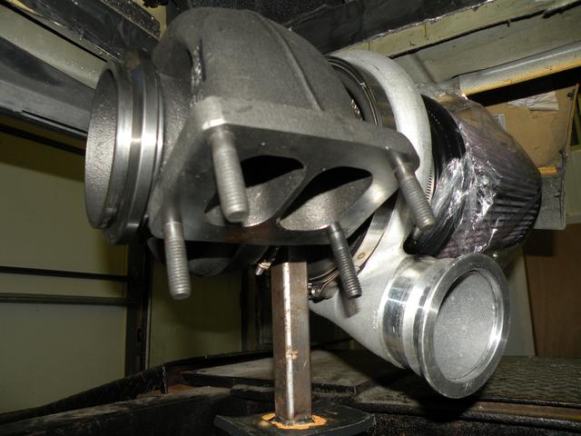

Because of the weight of the turbo a special mount had to be created to hold it while mounts were planned/created. It also came in handy when removing/installing the turbo in the car several dozen times.

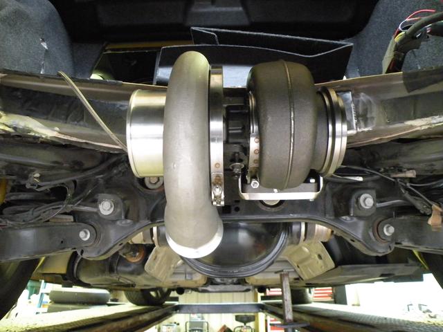

Now the real fun could begin! We spent some time measuring, checking, and measuring again to get the turbo position just right; low enough that we could later fit a false trunk floor, high enough that it could not be seen from the rear of the car, and the turbo shaft parallel to the rear axle of the car.

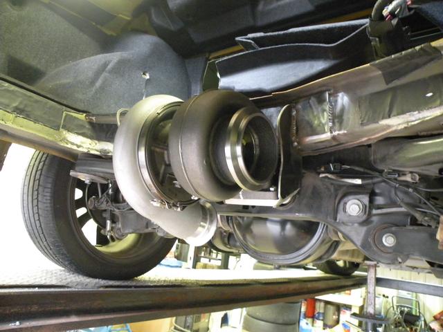

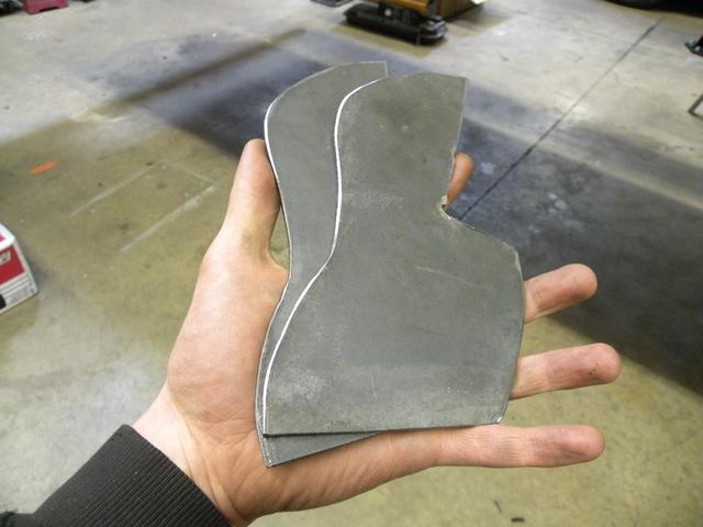

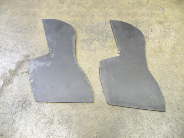

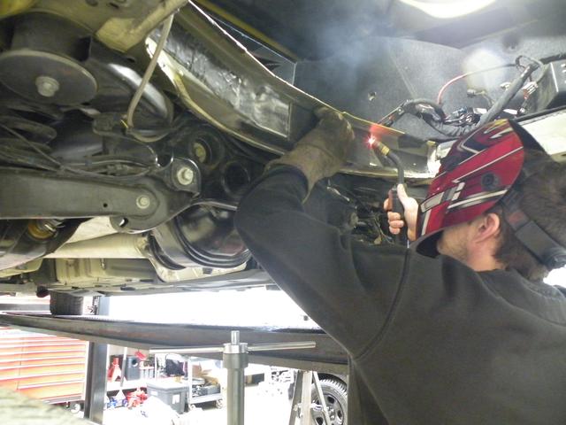

Now that the position of the turbo was finalized we got out the plasma cutter and began creating some mounts.

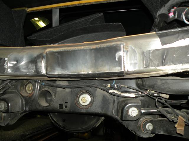

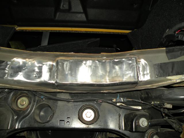

We added some structural support to the car’s frame where these mounts would be welded. This is a heavy turbo and we made sure it wasn’t going anywhere.
Next the turbo flange could be welded between the mounts making sure it was completely level before fully welding. Finally the turbo was studded and bolted to the car with the stand removed! It definitely looks mean up there.
