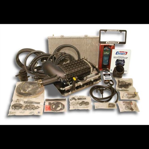

Except for Andy. You made me cry...just a little... :D Looking at the pic of the Ram version I can see they are indeed completely different designs. Oh well, was hoping for an excuse to go TT, now I'll have to find another one.
Actually, looking closer, it's just the front snout that is different possibly? I already had to swap the snout on mine when it had 2k miles on it, looks like otherwise its the same unit?
