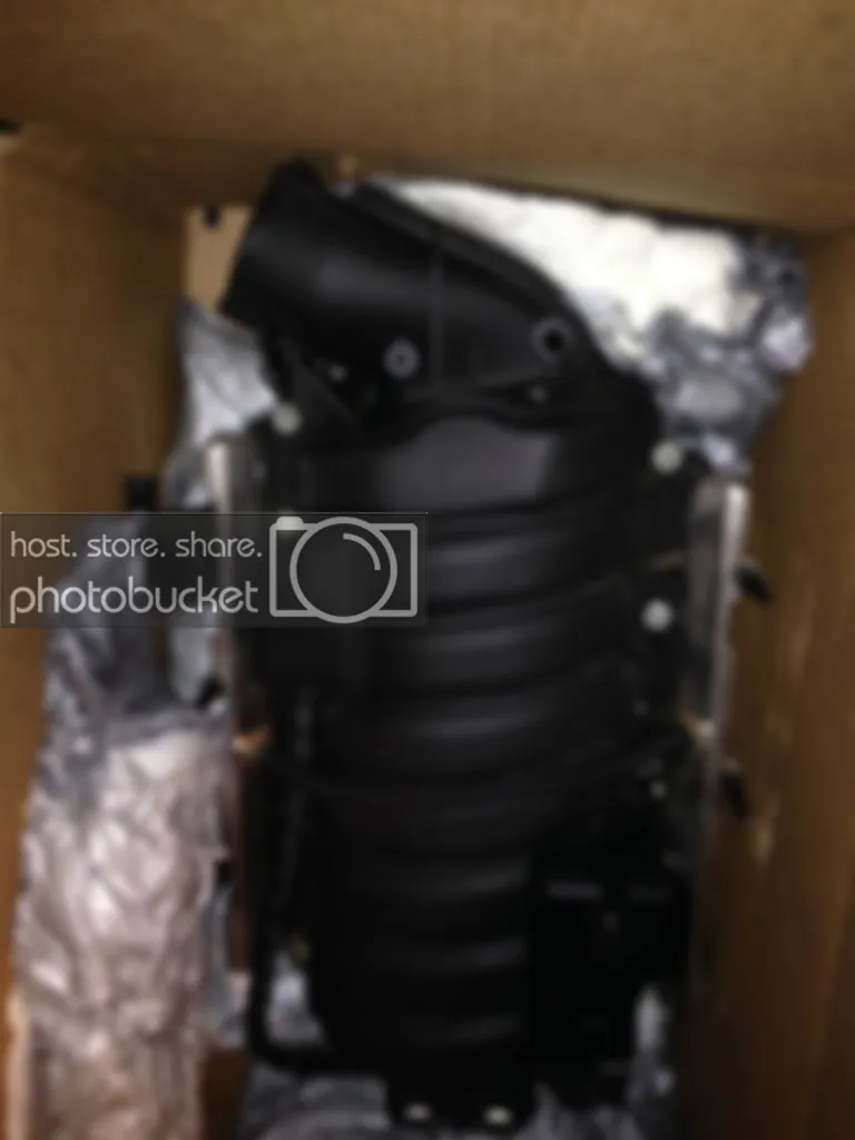

It would be cool to see a dyno run after this was done. I've heard of the gens before us actually losing power switching to the 6.1 manifold. Whats the material the 392 manifold is made from?
Hey! That was off my car. I'd recognize that packaging anywhere. There's a lot of good mojo in that intake! :)
