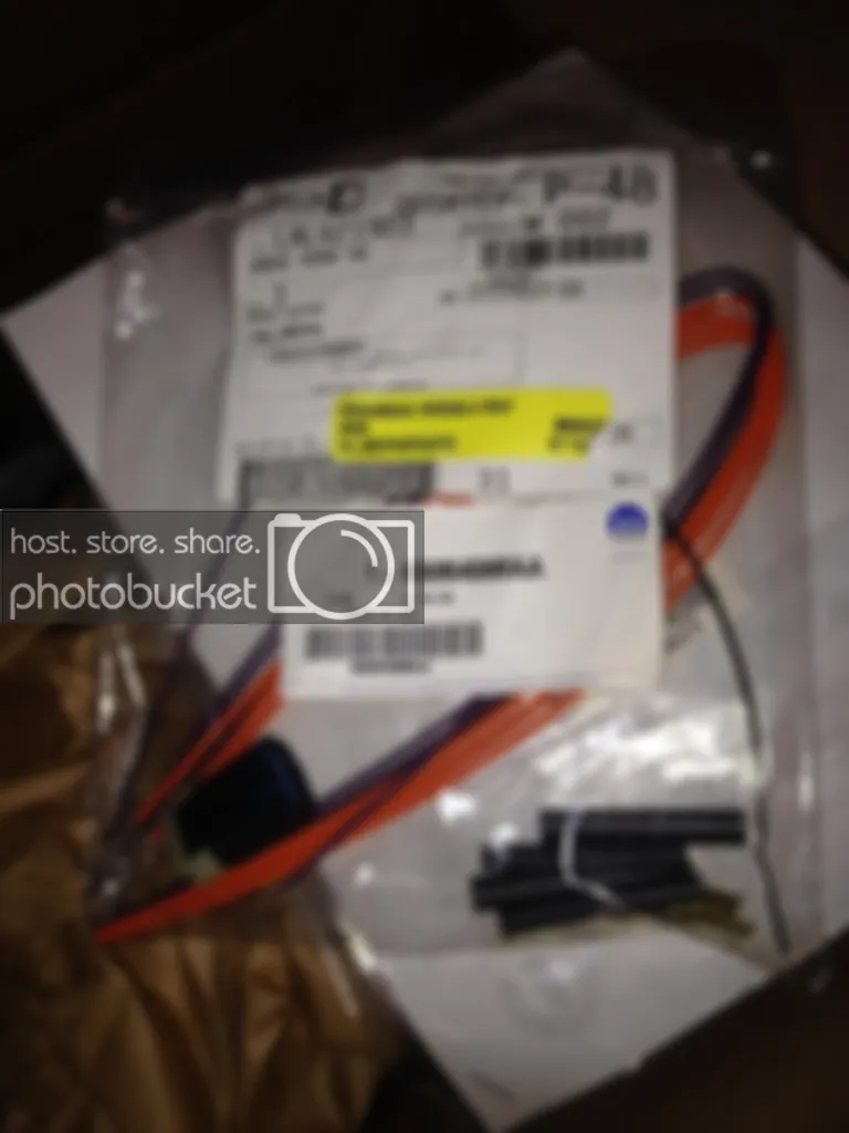

Pigtail connector: 1-68064996AA

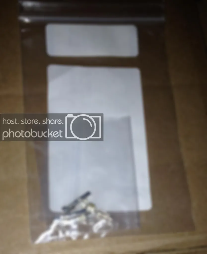

Mouser Electronics Inc. P/N 538-19420-0009

When extending the IAT harness, you can use the two purple wires that come with the pigtail connector (1-68064996AA) as wires to extend your IAT harness if you have a 2011+ since they don't make a IAT extension harness for 2011+ yet (I couldn't find one). 2008-10 might want to use them as well since the IAT extension harness is only 9inches and I believe it would come up just a little short. Or you could just buy two IAT extension harness I guess and connect them together to have the needed length.

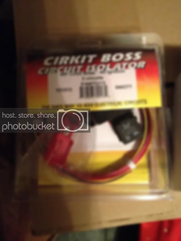

Cirkit Boss

Mopar pigtail connector
Mouser pin

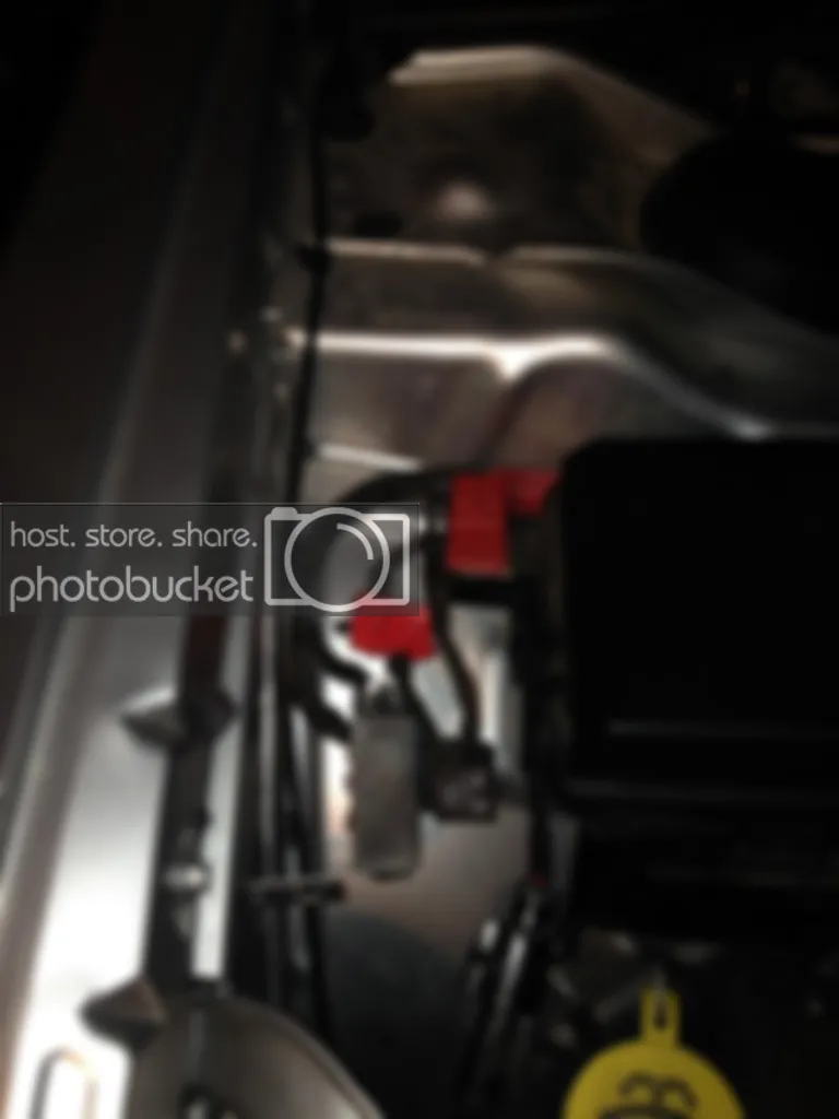

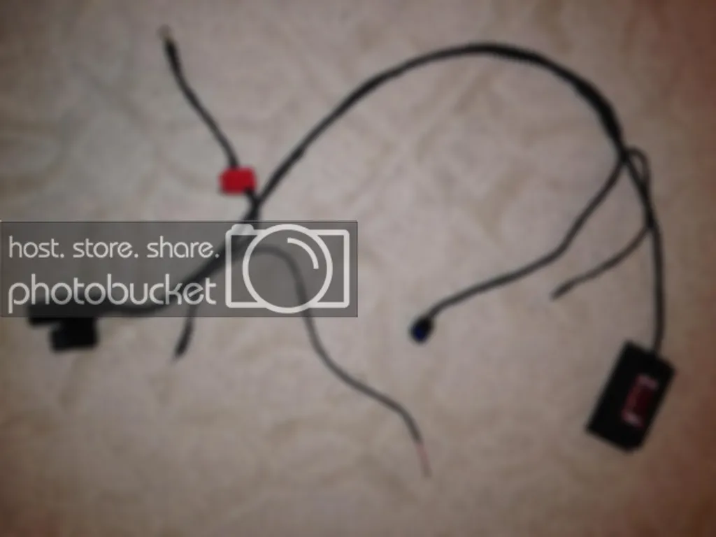

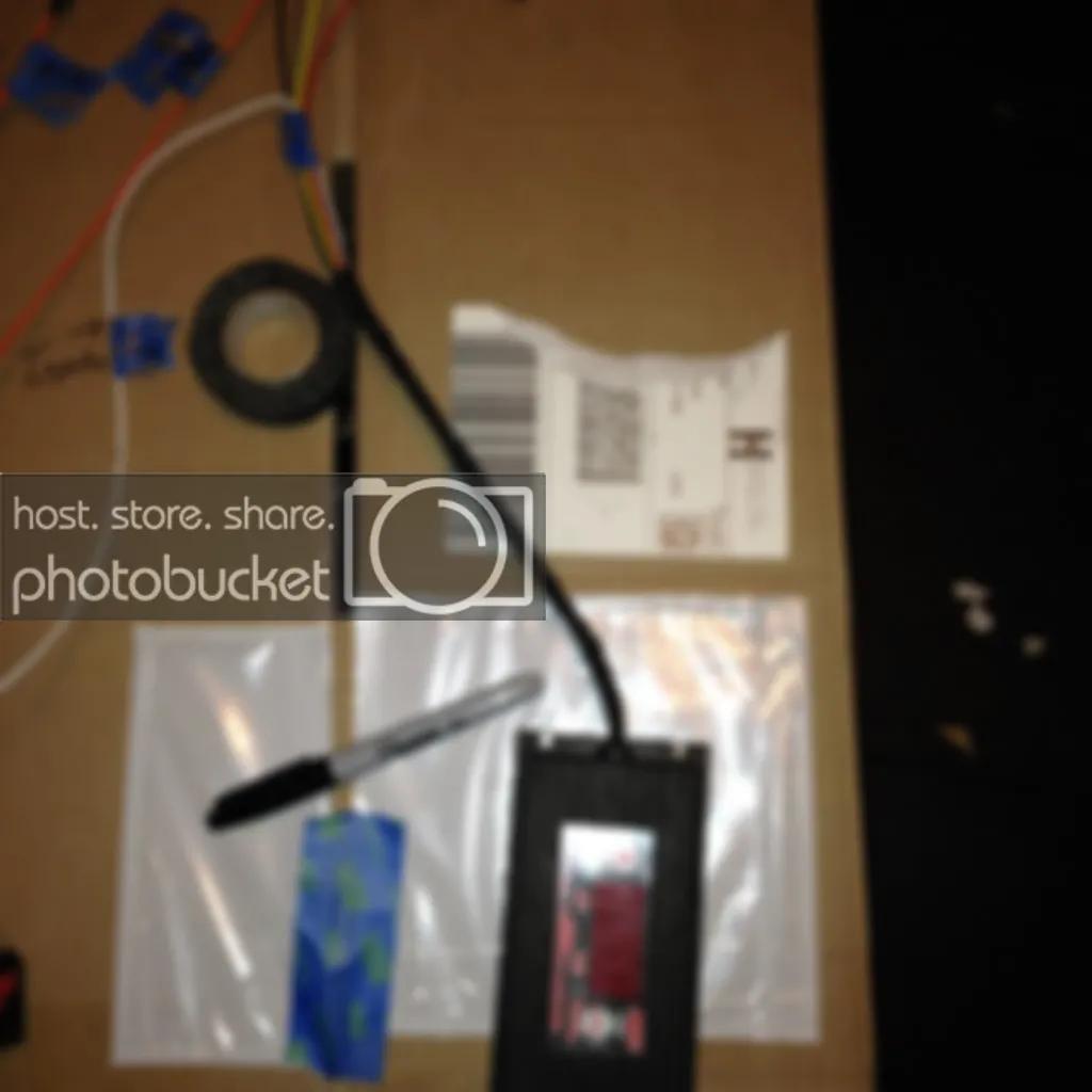

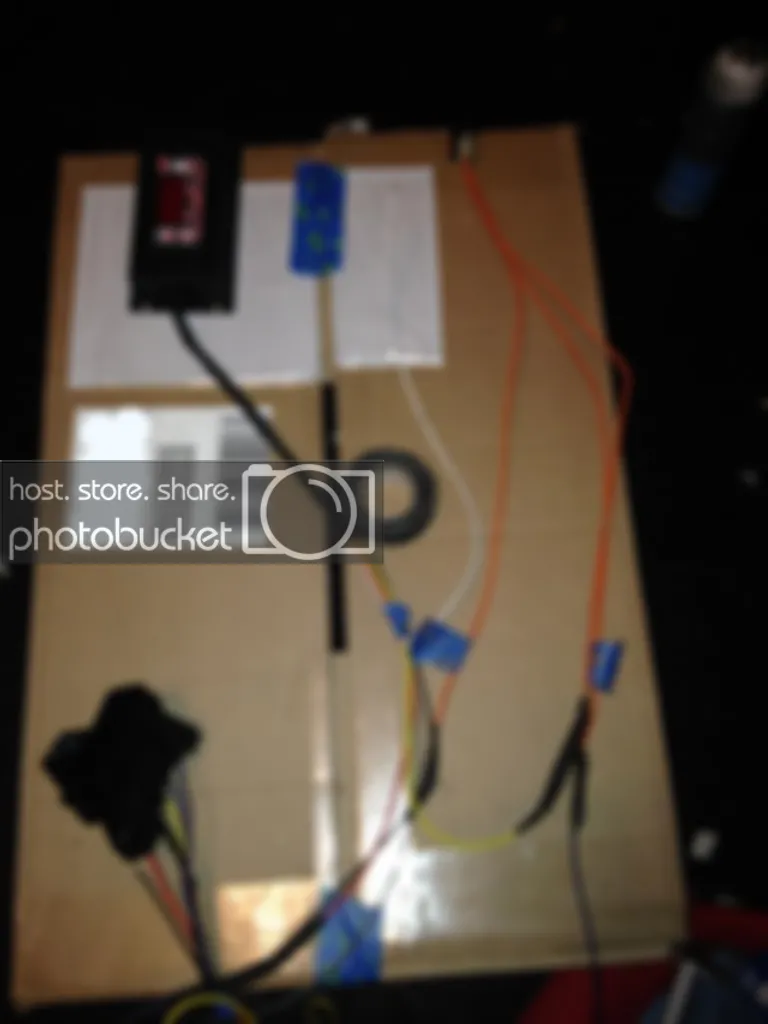

Last night I connected all the wiring. Connected the MDS, Cirkit Boss, and pigtail connector. I'll have pics of it wrapped when I get home tomorrow.
Everything connected minus the tape
d2c15fc8-6e27-4b3a-b6f0-64610b020cd3_zps
MSD
d92813b2-7a3c-4bfb-b873-6f7e959cc87b_zps
Pigtail connector

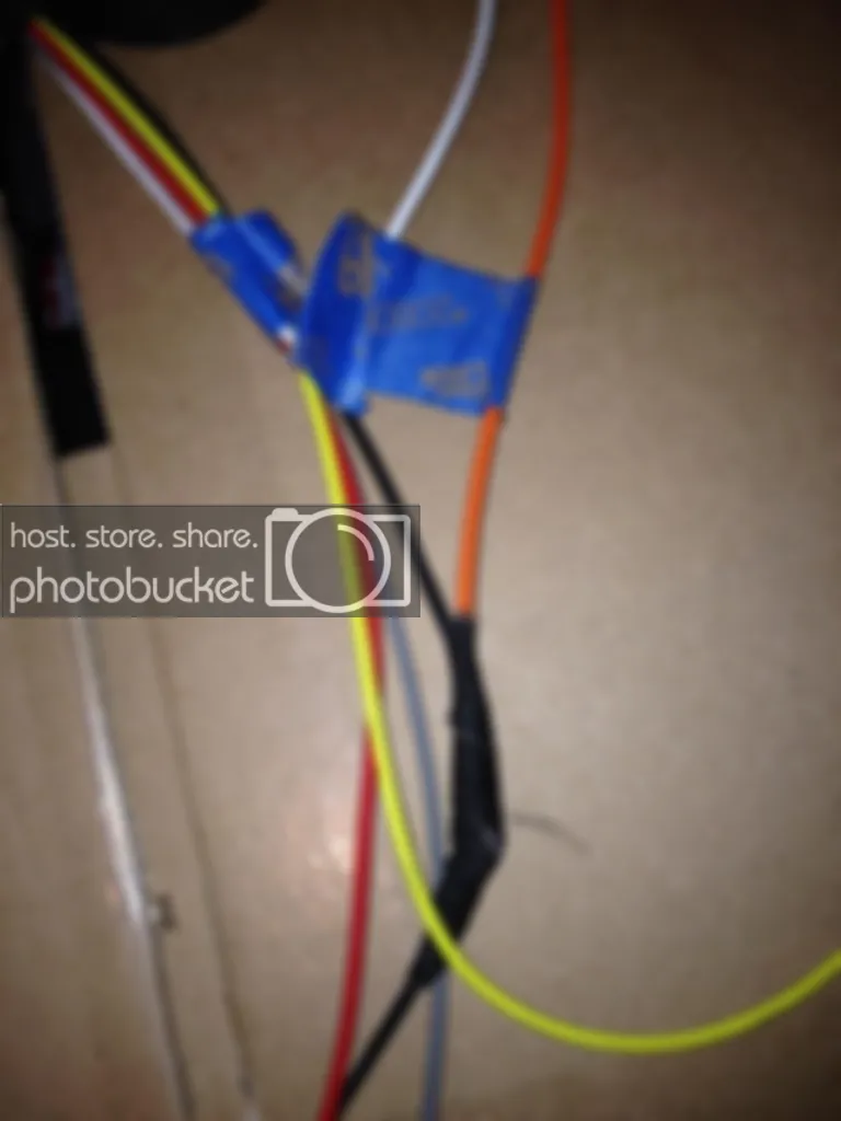

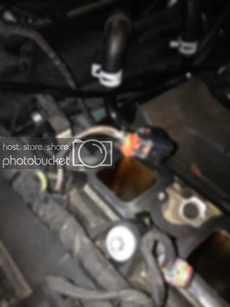

MSD/Pigtail connector connections
74164c4a-1879-43d5-99f2-0cadfe97dd7a_zps
Connected the pigtail GROUND to MSD GROUND

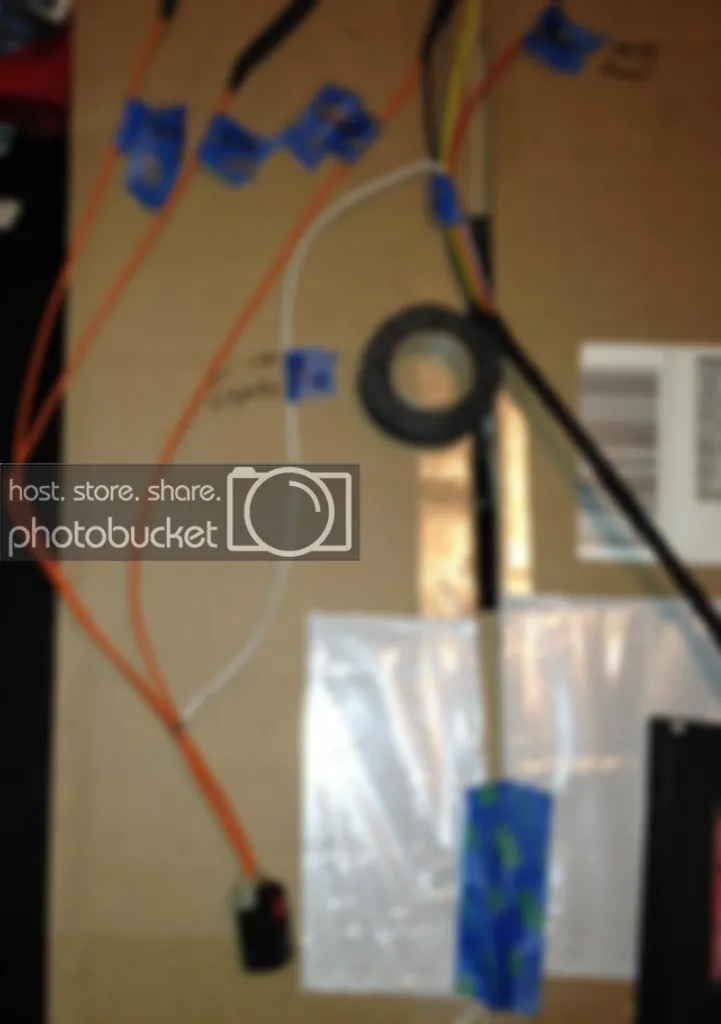

Connections to the Cirkit Boss
0f703676-49c7-4c12-ab67-015e3ab677f9_zps
Here's the wiring all wrapped up to protect it and to blend in with the factory wiring.
The injector wire I piggy backed the (white wire) MSD to.
Where I connected the Cirkit Boss

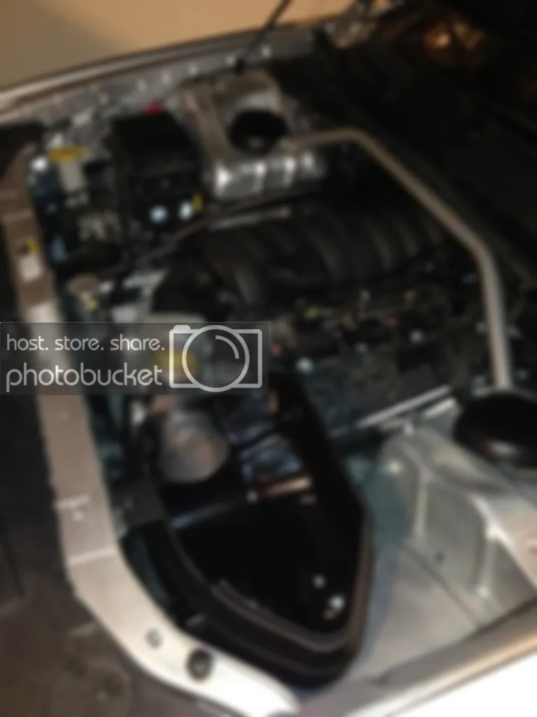

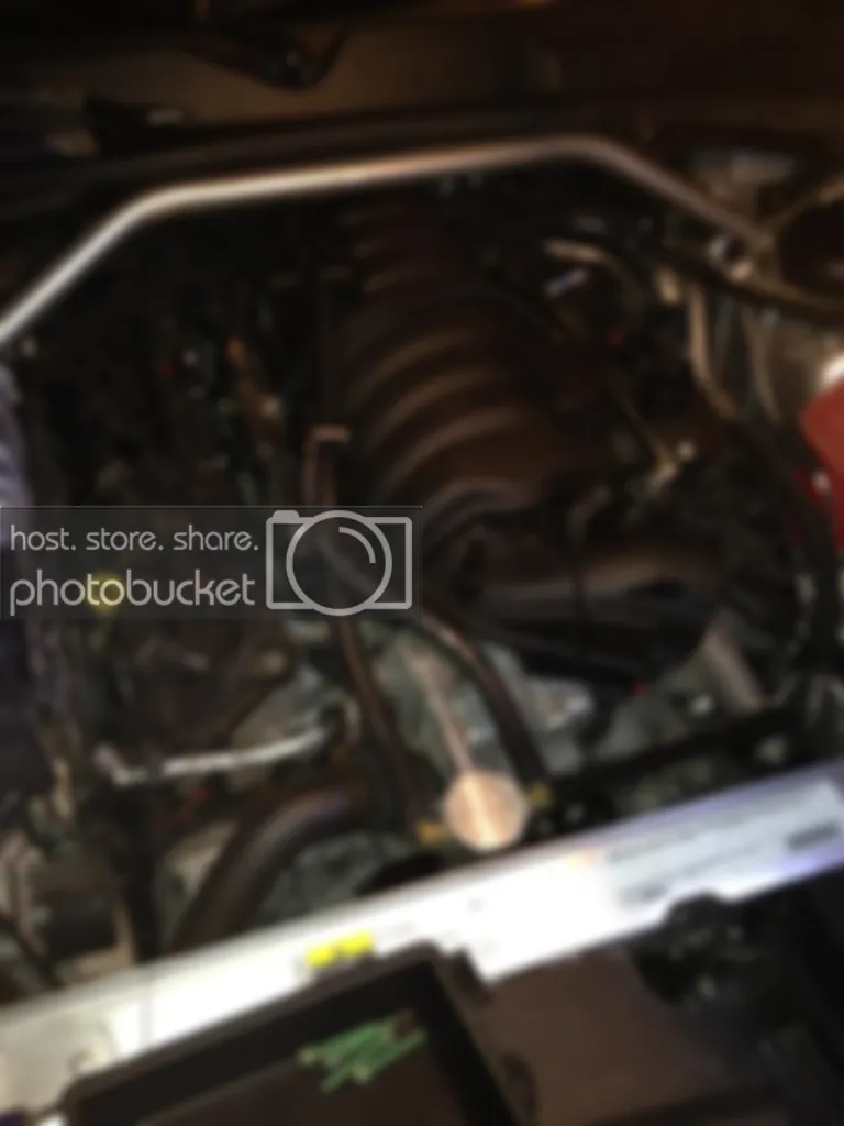

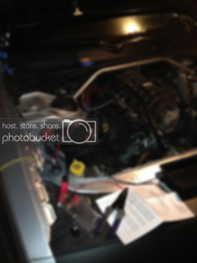

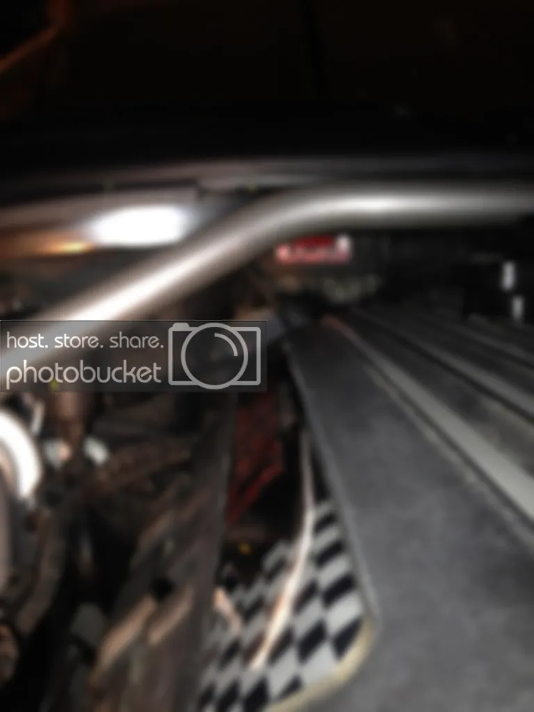

Put the 392 intake manifold on
Have the MSD tucked away safely but able to reach if adjustments are needed (sorry it blurry)

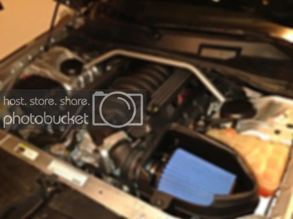

Fitted the 6.4 mopar CAI in
re-installed the coolant tank as I had to remove the 2010 tank (T/A hood) for now until I can modify the CAI. and installed the half covers. All I'm waiting for now is the IAT wire extension I ordered from the dealer.

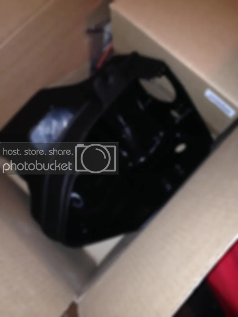

Hey! That was off my car. I'd recognize that packaging anywhere. There's a lot of good mojo in that intake! :)
Yeah, pretty awesome packaging, I'll probably reuse it when I sell my 5.7 intake. Thanks again for such a great deal.
