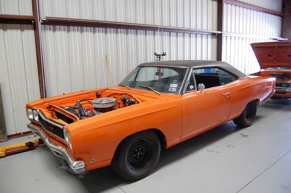

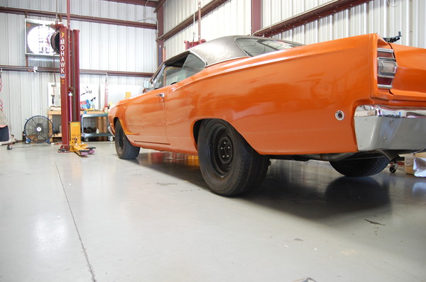

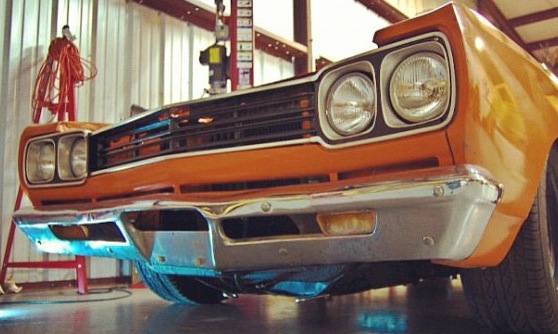

Here are some already shown pics of my car...
LowRR.jpg[/
iDSC_0529.sized.jpg[/
