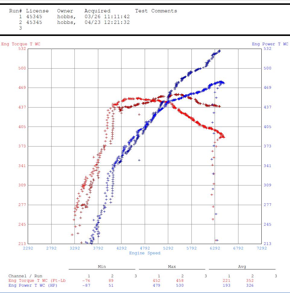

Ok... so here is the result of the tuneup on Stevo's car with a cam and springs swap. I worked hard to keep the timing identical to his tune that the car showed up here with so we were comparing apples to apples. In my book this was a very mild tune and I even richened up the fueling quite a bit to try to make his #4 piston live as long as possible. Ultimately the power gains could have been much larger.
I could make the torque curve vary at will by simply moving the cam and ended up with what you see here. She is pulling like a freight train out the back. Also, keep in mind I stopped at 100rpm less than his baseline pull (again to keep the #4 piston alive) but with the direction of the curve 100rpm more would have been some more ponies for sure.

There's a significant torque gain after about 4900 but before that it's under the previous curve. It also drops sharply at about 6000. Stevo if you don't shift above 6000 where will that put the engine after the shift?
Cool stuff!
I think you're looking at the wrong curve if you are speaking about the data for the new cam dropping sharply after 6000. In fact the torque curve goes flat (for the new cam) at roughly 6000rpm and is a truly beautiful thing! If calculating HP this is what any engine builder or tuner would love to occur. Remember HP is a calculated number based on torque.
(Torque x RPM)/5252=HP so the longer you can stretch that torque out, especially at the higher RPM's is a sweet thing.
With that being said the loss of torque over the previous cam in the lower RPM range as well as the huge torque increase at the higher RPM's will make this cam ideal for a 7000+rpm shift point with an RPM recovery in the lower 5000 to upper 4000rpm range.
