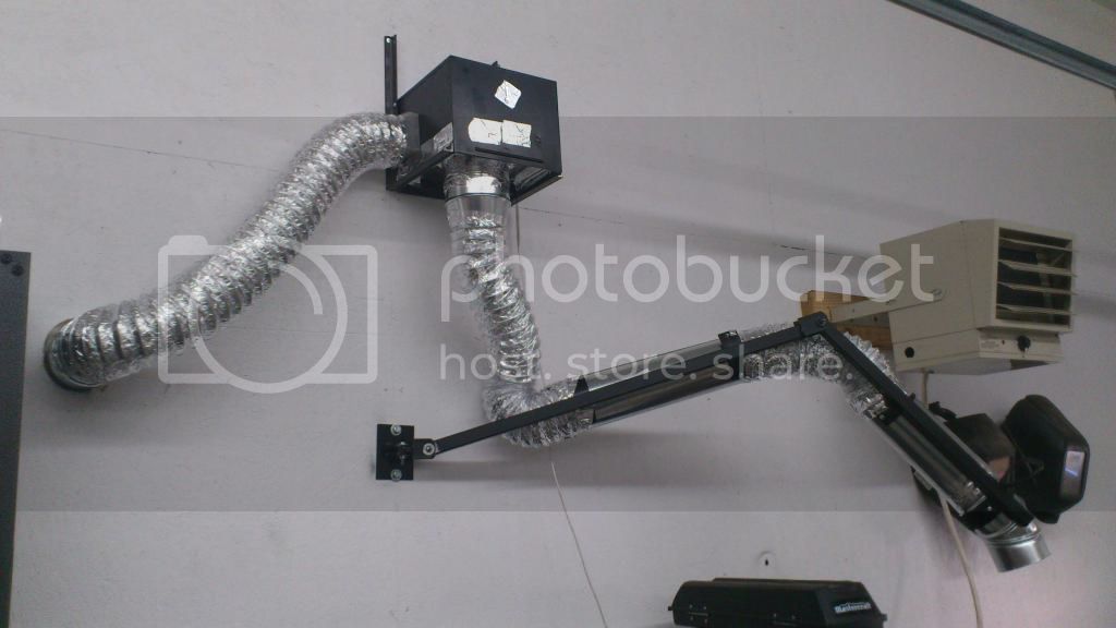

I'm sure Mani will get a good chuckle out of this, but it works awesome so I thought I'd share.
Last winter I did a few projects where the amount of smoke and dust in the shop felt unsafe, so I knew I needed something. In the summer months I work with the doors open, but when it's cold I don't want to lose all the heat.
So I made my own fumes extractor with scrap I had lying around. I used an old bathroom fan which is rated 130cfm.
The head is a standard 4" household elbow, which I can pivot in any direction, and attach a variety of 4" adapters or even a length of flex pipe if I need to extract fumes for farther away.
Home made pivots using scrap metal and cheap bolts and a bit of grease. Works great.
I closed up all the doors, cracked a window, turned it on and welded for a few minutes without any noticeable smoke in the shop. Total money spent is about $70.

Pretty slick set up. I've been thinking about putting an exhaust fan in my shop for the same reason. Last time I did a burn out in there it took a half hour for the smoke to clear out. lol

I hadn't thought of that requirement in a commercial setting... At first I tried filters, but you need some pretty serious gear to filter out that toxic smoke. Blowing it outside works better (when you can) and putting the head right near the torch sucks up all the nastiness.
