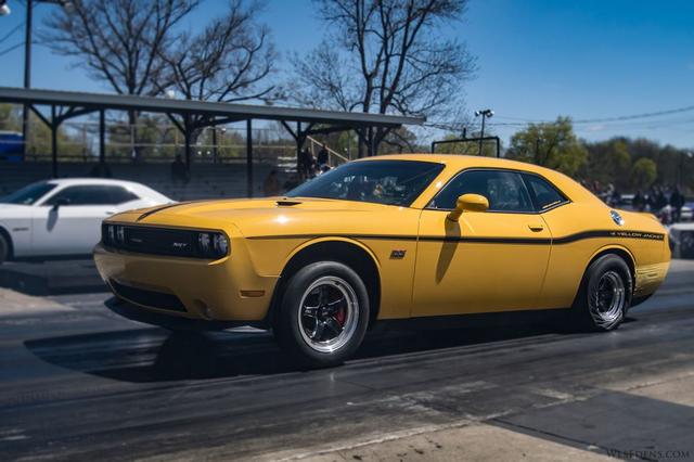

I want to say thanks to Mike and Micah at OST for making Challengerfest 7 the best ever for me! It all started a year ago, at the end of CF6 when I decided that I wanted to upgrade my engine from the stock block. I had been working with Mike for a couple years tuning the Procharger, but I was really impressed by what his Jeep was doing with the HRH engine and big turbo. After much discussion, we decided on the HRH engine, turbo, clutch, driveshaft, differential, axles, 15” conversion, triple pump return fuel system, and racing suspension with a plan to have the car ready to start testing in the Fall.
Micah is handling what I consider to be the REAL build thread, with detailed technical explanations and lots of pics. This is the story from my (not-very-technical) point of view.
Parts delays held up the engine, but it was installed and fired up the first week in October. Then we got hit with the now-infamous reluctor wheel problem (which you still can’t mention around Mike without him cringing). That cost us a few months worth of delays, but meanwhile they kept plugging away at non-motor items (roll bar, clutch, drivetrain, 15” conversion). Even if there was nothing to report, Mike or Micah always contacted me to let me know how it was going. The engine came back out the last week of December, then went back in with the stock reluctor wheel from my old engine at the end of January. After that, Micah went full-bore on the turbo system, and fired up the car exactly one month before Challengerfest 7. Not counting the delays from parts, the build took about 8 weeks. With big things done, but still a giant list to-do list, they went into “triage mode” and focused only on the things necessary to get the car onto the track in time.
I showed up on Tuesday before Challengerfest weekend, and there was my beloved Yellow Jacket that I had not seen in several months, all washed, waxed, polished and ready to go. I hadn’t realized until just then how much I missed my car!
Mike took me for a ride in it first, to show me what to expect when the power comes on. It was pretty insane. My street tires are the Continental Extreme Contact DWS, which are great all-season tires, but not so great 1000+ HP tires. We were breaking loose in all gears before he could really show me how the car could pull.
When they handed the keys to me, I was fearful. I had seen both Mike and Micah drive it, both more experienced drivers than me, who BUILT the damn thing, and they were taking some effort to control it. I was pretty tentative, and even stalled it a few times (they were nice and said something about it not being as driveable because they hadn’t worked on the street tune, but still). And I was seriously going to take this thing down the track in 3 days?
The next day we finished up some things around the shop, and I drove it a little more on the street. Both of them sensed my uneasiness because each of them had separately asked me at different times if everything was alright. I think they feared I wasn’t happy with the build. In fact, just the opposite. The car was everything I had hoped for and more. So much so, that it made me anxious as all hell, wondering if I’d be up to the task of driving this thing down the track, keeping it and myself in one piece. I had grown comfortable with the Procharger and stock block combo, having driven it for 3 years. That was familiar to me. This new car, a magnificent machine so powerful and so strange might be too much to handle. I feared that I might not be worthy of it, that maybe I had bitten off more than I could chew. Maybe I had made a mistake with this whole “big build” thing. Yet there was no going back. My old stock block had already been turned into the prize to be won at CF7. My Procharger had been sold to somebody else. Even my old Getrag and driveshaft belonged to the Sprintex car. My old familiar friend had already been torn into countless pieces and scattered across all of Mopardom, never to be seen by me again. I could only plunge forward. So I put on a brave face and told them that I was a little nervous about driving it. They were very supportive and reassuring.
On Friday I was going to take the car for a few easy passes, get used to rowing through the gears down the track. I stalled the thing right after the burnout box, and I think it was my nerves that made me forget the whole “take it easy” idea, because once I launched it, I just wailed into it all the way down the track. So much so, that I lost traction in all 4 gears. Almost gave Mike a heart attack, because he thought I was going to go sideways.
When I came back, Mike said, “What was THAT? I thought we were going to go easy?” I felt bad, but I had just gotten so excited being out there, and there was the car in the other lane that I just HAD to chase down. Mike was understanding, thankfully, so the second pass we decided to try a couple speed shifts. But the car got squirrely on that one too, and with the cold weather and lack of track prep, we decided to pack it up and save it for Saturday’s racing. Good thing too, because right after that decision it started to hail.
That night I slept well. I was no longer scared. I was relieved, happy, and confident. I felt that maybe I could do this after all, and so Saturday I would really focus on getting them the data that they needed. I started out the day with a 12-second pass, followed by an 11.5, and then an 11.4, a personal best for me. I was learning the car, and speed-shifting most shifts. My timing was way off, though, and I probably hit the rev limiter about half the time. The real trouble started when I raced Murray in the 6-speed shootout and couldn’t make the 3-4 shift due to grinding.
I took it out again to see if it was me or the car, and sure enough the car wouldn’t go into 4th, it would just grind. Mike knew what the problem was even before I got back to the pits. I had red-lighted at the start of the pass which should NOT have happened with the clutch fully engaged at the light. The car was creeping forward (I don’t use the line lock on launch).
To eliminate the possibility that it was my driving, I asked Micah to take it down the track. When he did, he confirmed the same thing happened, but that time in the 2-3 shifts as well as the 3-4 shifts. We did one final test back in the pits. We revved the car to 4,000 RPM in gear with the clutch on the floor, and sure enough it was creeping forward ever so slightly. It’s a McCleod clutch, but one that they make for the Viper. To fit the Challenger, they custom made a flywheel for us. Micah was on the phone with them constantly, checked the air gap and put it together with the specs McCleod gave him. He tested it by lifting the rear, putting it in gear, engaging the clutch and checking for wheel spin on throttle. No spin. Everything seemed fine, and it even passed speed-shifting tests both on the dyno and the street. Still, there is no test like taking it down the track. We think the clutch is heating up, causing expansion that prevents full disengagement. We need to shim it.
Those of you who saw my runs or the videos know that I took the term “shake-down” passes literally. Micah said my burnouts looked like a video game where they exaggerate the shaking, rumbling and smoke for dramatic effect. Aside from the clutch, the car performed flawlessly. All the electronics worked as they should have, the engine was making great power (when I had traction), the turbo sounded awesome as all get-out. IATs at the top end never left double digits. Nothing leaked, nothing fell apart. We never turned a wrench on the car the entire weekend. Everything held together despite my attempts to the contrary. Here are the videos of me trying to destroy the car from the get-go: http://modernmoparforum.com/topic/17480-ost-dynos-1000whp-turbo-challenger-build/?p=449517
I was really hoping I wouldn’t break the car this weekend because I was so looking forward to driving it again! My wish came true. Even though there are a few minor things left in the build, Mike’s letting me take it to enjoy it for a while. Get some street time, get comfortable with it. The intent all along was to make a 1,000+ HP daily driver, so now I get to sort out the daily driving part. Any issues that crop up will go onto the “Phase 2” list, and when I’m ready I’ll let it go once again to OST for completion. Well, completion of Phase 2, because there will probably be a Phase 3, and so on.
If I wanted easy, I would have bought a Hellcat. I didn’t want easy, I wanted different. I wanted something special, something unique, something nobody else has (or maybe even wants). I wanted to learn things, which I did. I’m really grateful to OST for giving me all of that, my kick-ass 1000+HP Yellow Jacket. A car that may frustrate me at times, teach me at other times, and challenge me most of the time. Thanks guys, for being there every step of the way, and for taking me on this awesome journey!
