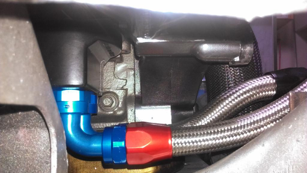

Remote filter and oil cooler plumbing..

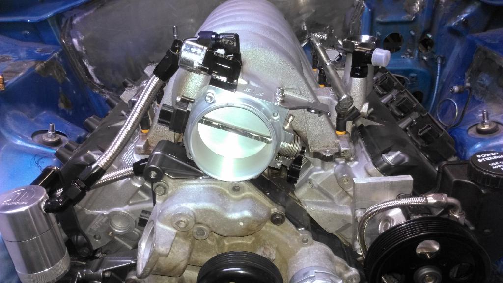

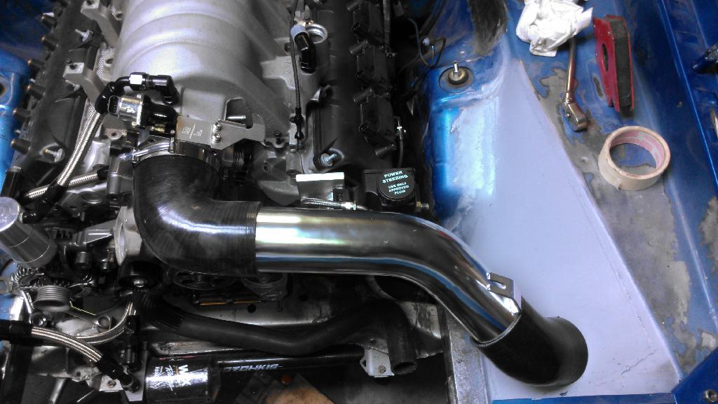

EFISource 92MM TB and breather tank mocked up..

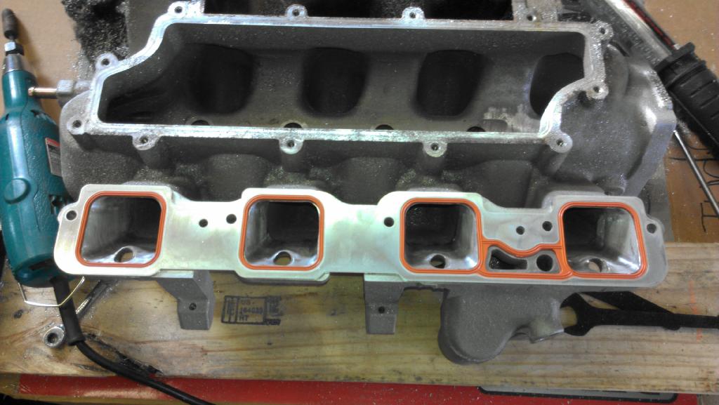

Intake hand ported a little...
Intake PC'd and 80lb Dekas installed..

What it that on your throttle body?
Thanks everyone, the throttle body has an IAC sticking out of it. I have since flipped it 180 degrees.
