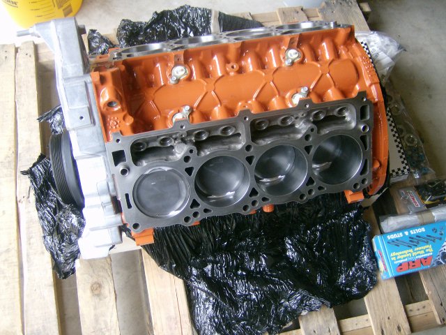

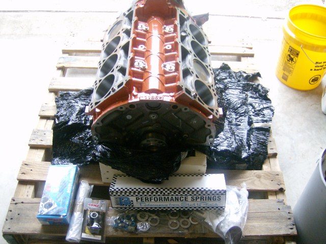

Look what arrived yesterday from Arrington: lol;)B)
Forged rotating assembly 6.1 to 392 Stroker block. My 2009 5.7 needed an upgrade after almost 4 years of stock w/ bolt ons and a tune and I wanted to start with a solid foundation.
Thanks to those here on mmf for providing input over the last few months about which direction to go.
Also, thanks to Justin at Arrington and shopHemi for walking me through what I wanted and making sure it fit my future plans down the road and getting my order shipped out on schedule as promised.
I plan to document the self install here on this thread over the next month, or so (It took 4 months)... I'm sure I will hit a snag or two and look forward to hearing any tips that might be helpful and would be greatly appreciated. Hopefully this thread might help others as well.

Looks like Christmas came early for you this year!
This will be an interesting thread to follow.
You gonna do the install Arrington style (from below) or old school (from above)?
Old school. I put my hoist together today and cleaned up the garage. Not sure what to do with my hood during this minor mod.
I just hope "interesting" doesn't mean like watching a race just to see if there is going to be a crash... :o :o :oB)
Good stuff. You'll love the motor. I ran it with an Arrington 607 cam (had a blower) and it was a nice combination. That cam was discontinued (I gave them my old one since they supplied me a cam for the TT's) so what are you running for a cam and what CR?
Mike (GSO) and a few others here are good sources of info. We've got someone local you can lean on (LX or SCLX forums) who does this all day. oSo. He's good peeps. Just tell "J" I sent you and he'll offer some advice.
Best of luck with the install.
I went with Arringtons ST-3A Forced Induction cam 225/234 592/594 114 LSA
Regarding the CR, For now I am keeping my existing stock eagle heads but installing Arringtons performance valve spring kit. I would have them big valved and reworked before a sc but for now Justin said they should work fine because of the smaller chamber and I think he said the CR should be around 10.3/4. We are also compensating for the smaller head chamber by using a thicker head gasket to increase chamber size just a bit.
(CR ended up being 10.11:1 or approx. 10:1)

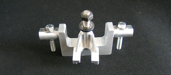

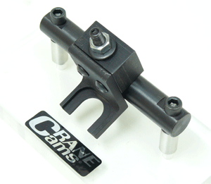

Help, tools needed. I know you never get anything if you don't ask so I am asking. If anyone has either or both of these tools please consider lending them to me. I will gladly reimburse for shipping and insurance as well as throw some extra cash in the return package. PM me please.
1. Hemi valve spring compressor tool like this one from Superiorautomotive or Crane Cams that are supposed to make changing springs take minutes vs hours with much reduced frustration...
2. Clutch alignment tool like this one:
http://www.ebay.com/...4ba2587&vxp=mtr
Any takers willing to be without them for a short while? :huh:
