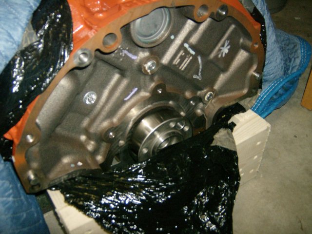

the bushing is on the pallet wrapped in plastic
No....the bushing that is pressed into the crank that was included with the motor(the parts you have spread out) appears to be for an automatic and not a 6 speed.
Those are all parts for upgrading the springs on the heads.
This is a common problem when buying an engine for a manual trans car.The crank needs a pilot bearing installed.No big deal,just buy one.You hopefully would've seen this when you pulled the old motor out & pulled the rear main seal retainer bolts.Also if the main studs are ARP, you will have to clearance the oil pan to fit in the rear.
So is something wrong here from Arrington or what?
Is this not right for a manual trans?
Doesnt look like anything is installed in there. You need the bearing that gets pressed in there. You can see an example on your old motor.

Just got with Justin and he is sending out the pilot bearing and a rear main seal. Just shows its good to have another set of eyes.
