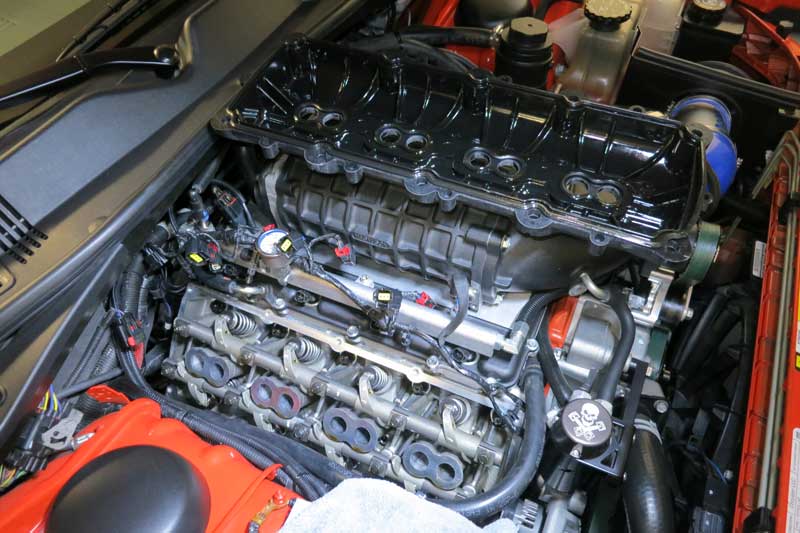

Well, I got motivated and went and pulled the passenger side valve cover to have a look at things. What a PITA pulling that thing is. The wiring harness and heater hoses and what not back there make you really have to fight with the dang thing to get it out and I tore the valve cover gasket on the back corner getting it out. I'll swing by the dealer tomorrow and get a new gasket and try to find an easier way to put it back in.
The springs all looked fine. The intake rocker on CYL 4 is loose as hell and the push rod has about 1-2mm of play in it between the lifter and rocker. I can literally spin the push rod freely so it's really loose. Diagnosis, collapsed lifter just as I suspected. Oddly, it wasn't in CYL 6 where the green plugs were so I don't know what's up with that. The plugs in CYL 4 look fine but that is right in the area I hear the loud ticking AND I find this pushrod/rocker much more loose than all the others.
I'm gonna try not to have to pull the blower and head with a long shot. I'm gonna pull the rocker and spray some Chemtool or similar product down the push rod hole as well as through the pushrod itself, and then spray some through the push rod with it sitting on the lifter in an attempt to free it up. We'll see how it goes, but at least I know what the problem is and it's not gonna hurt the car to drive it around, it's just annoying. If these efforts don't solve the problem, I'll set some time aside after the New Year to pull the head and replace all the lifters on the passenger side.
