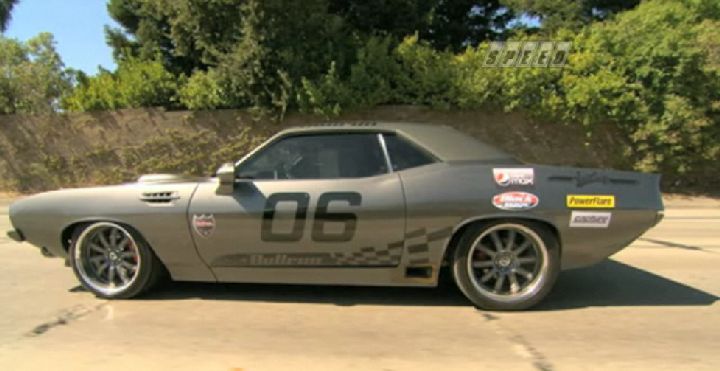

Here's that Bull Run Barracuda I told you about. It was a resto mod with a modern 6.1 in it.
Glad you joined the forum bud. Good talking to you the other day. Keep the pics coming.
THAT looks like a fun ride!!
