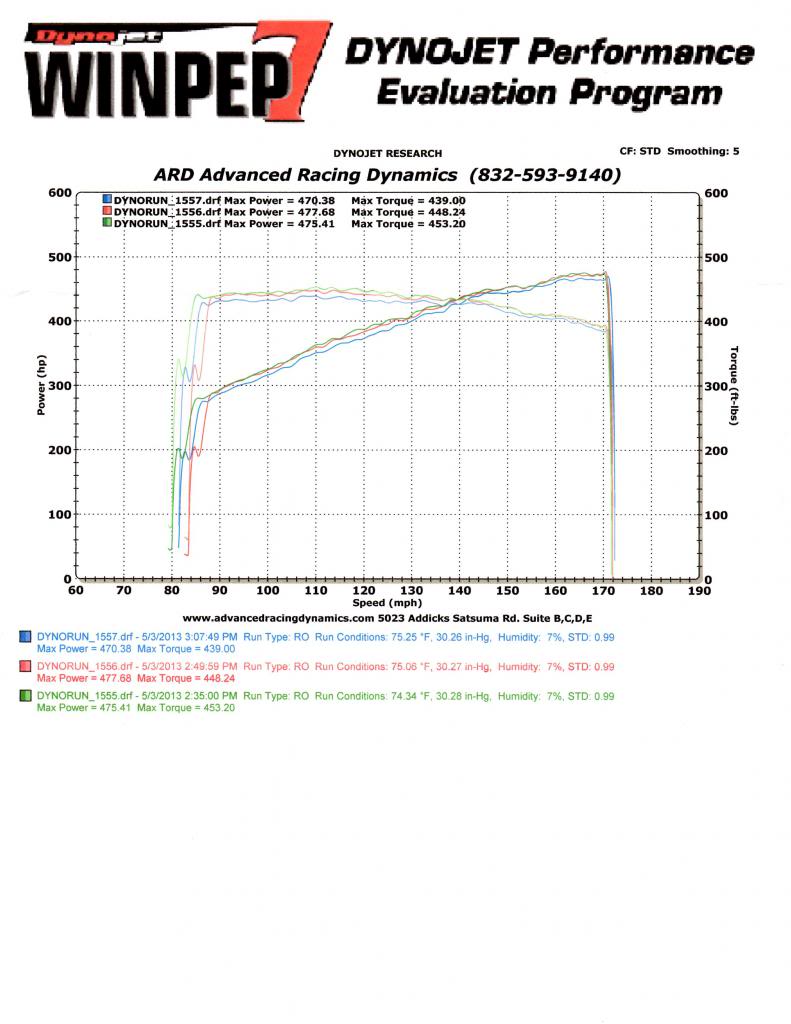

Well, I talked to Mike @ OST last night about all this. He said he's done one or two 392 cams via remote tuning but the customers haven't done any dyno so he doesn't have any data at all.
He's done a Comp 274 on a 5.7 car with a Kenny Bell and it picked up 100RWHP. He posted the dyno sheet on this forum he said, and I remember seeing it somewhere. He said you could see the power just pour on as he adjusted the cam timing in the tune. He's doing another one in a 392 here soon and will report back those results.
He did inform me the big issue with tuning is access to the necessary tables via CMR. He said Diablo has been working on it quite a bit, and are about 75% there, but that last 25% is what he really wants. The cars run good and the customers are all happy with them, but he said the low RPM and idle isn't as perfect as he likes them to be.

Here you go Jay...
Dyno with Arrington Magnuson Supercharger Tune
Running 9.261 for A/F Ratio and Total TIming of 10.5 Degrees.
Reduced Fuel -15% @ all RPM's and added 2 Degrees Timing on 1st and 2nd RPM Levels. A/F Ratio = 11.3 and Timing = 13.00
Dyno sheet , 392 cam and JBA shortie headers
Plus 43 hp total 354
Plus 27 trq. total 355
there is a trq. drop from 2900 rpms to 3500 rpms that i'm not too happy about.

Good info. Greg, yours looks pretty dang good except for that weird drop at low RPMs. Get that straightened out and I think you'll be happy. My only other concern there is the starting baseline was around 300RWHP when most stock RTs are 330. It wouldn't be too hard to look around for other RT baselines on Arrington's dyno to see what they made. Was it hot in the dyno room during the baseline or was the car heat soaked? That could account for some of it if so.
345_Chlngr - looks like you made the right changes to the tune to get it where I'd want it to be. I'm no expert tuner, but I know what's good and what's not. There is a modifier in the stock tunes for CAT OVERTEMP PROTECTION that can kick in at times and make the AFR go rich if the cat temp gets above a certain threshold. Most tuners turn that off in race tunes and leave it alone on street tunes. As you probably know, when this condition is met the PCM commands more fuel be dumped to cool the cat down. However if yours was like that from the get go, that wasn't the issue. One thing I have seen is that tuning on the dyno for 11.5 usually means 10.8 on the street. My theory is that the extra load on the car on the street makes the AFR a bit richer than what was tuned for on the dyno. Load based dynos help account for that if used. When I tuned my 4Runner on the dyno then road tested I had to take out a ton of fuel on the street to make it right. Noticed the same on the Challenger working with Mike at CF4.
Road logs are always the best bet for final tuning as that is actual running conditions, IMO.
I drove up Tuesday morning 5 hour drive got there about 9 am, dyno done about 9:45 I think. not sure how hot the engine was. the last dyno pull was after about an hour or more on the dyno, out side temp in the 80's .
yes the base line was 311 hp. not what I expected.
well if I can get that low end issue resolved I will be at VMP in two weeks.
Just got a revision back from Mike. The reason for all of my issues down low was to prevent KNK, that was before my false knk issues were resolved. Should be just fine now. I'll know in a couple of weeks.
